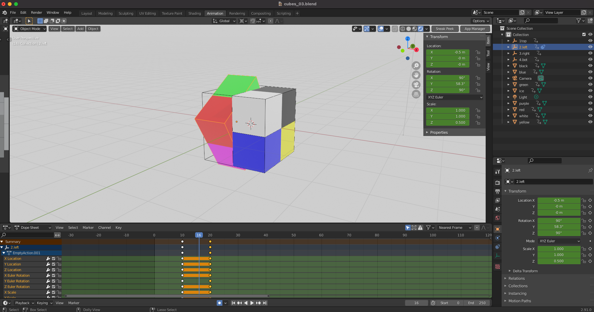

ParticipantHey thanks for your responds. I have tried creating “empty” blocks and having the blocks parented under them. see screenshot. only it doesn’t look like I’m able to use the empties for the “when clicked” in puzzles.
am I onto the right track here? thanks for your time.

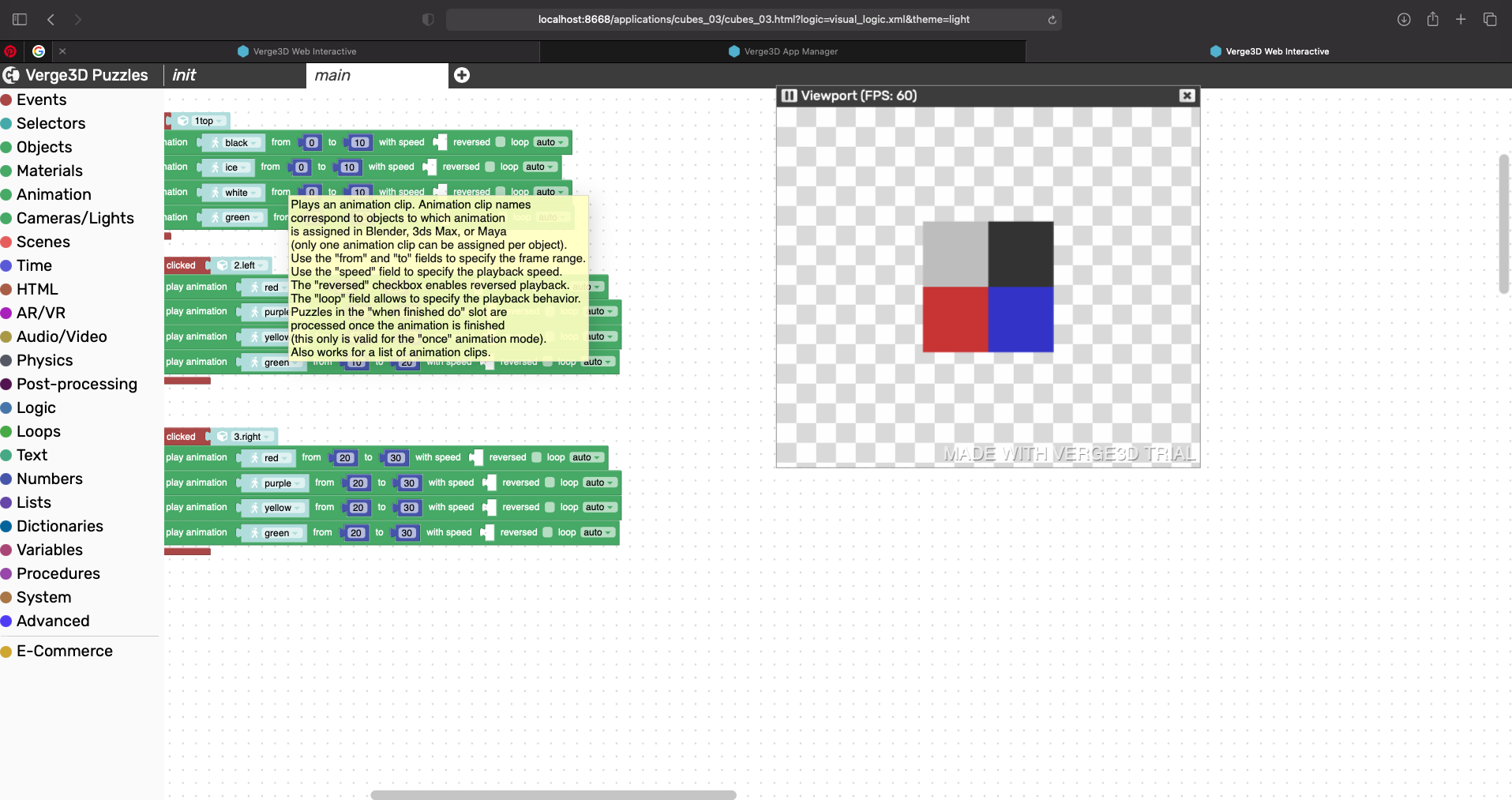

You’d have to post a pic of your puzzles for me to see, really.
You can just say animate from 0 to 90. With “updated value” puzzle be in whatever “change puzzle by” x,y,z etcVisit the GLIFTEK Verge3D Plugins Store!
