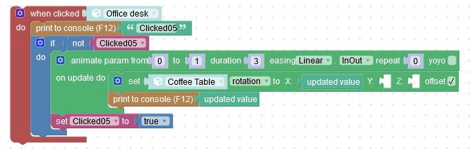

    animate param applied to a rotation. Watch the capture.
    What is the expected result?
    A rotation of the object “Coffee Table” when click on the object “Office Desk”
    What happens instead?
    No rotation + freeze of the browser tab.

    No problem occurs if I change rotation with location. The objects moves as expected.
