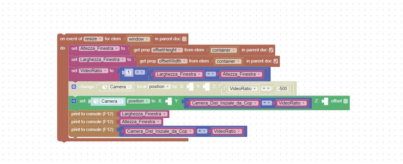

    fsguegl
    if i didn’t understand wrong, you have the same problem
    that I also had.
    I solved it by moving the camera according to the aspet ratio of the screen as you can see from the attached image
    #46490
    Is there a demo of this anywhere we could see?
