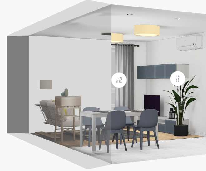

    See the picture: a nearly transparent plane is whown white and covers all other objects with alpha blending. Opaque objects are not affected.

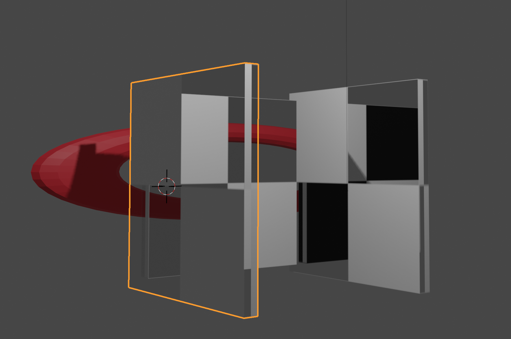

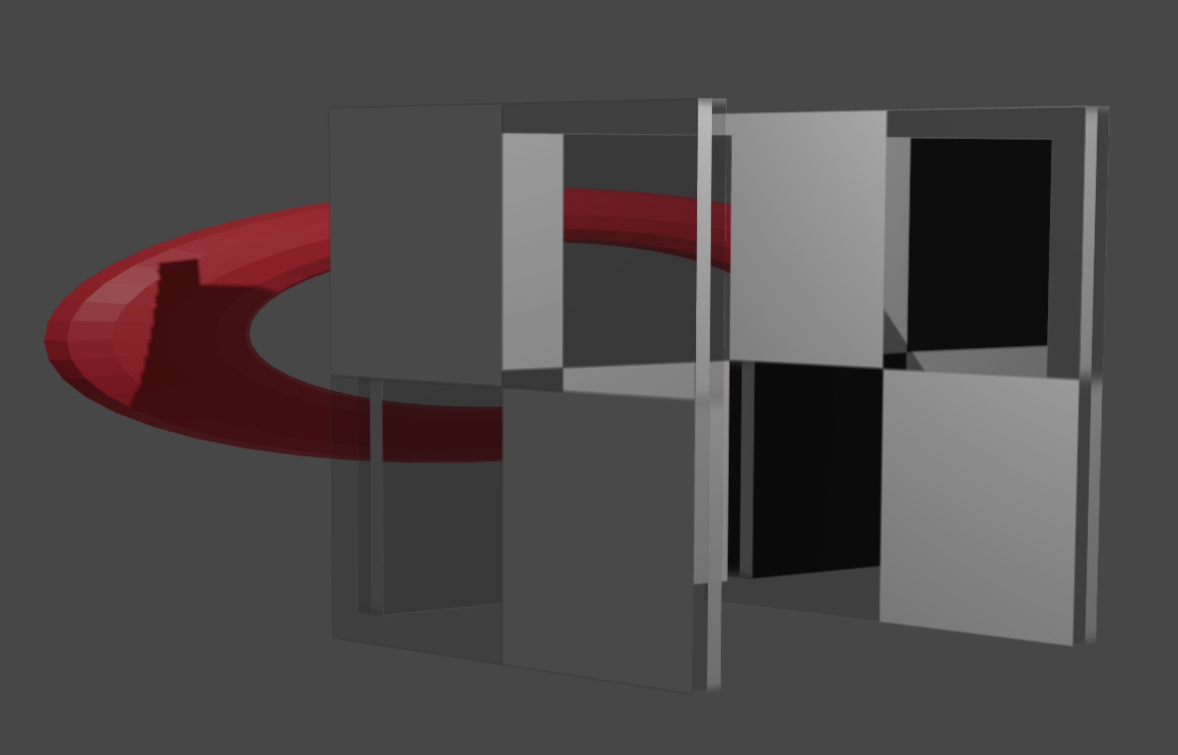

    Just tried a few things and the only thing I could do to recreate the issue was to have backface culling unchecked (off).
    Attached is a blend file with three walls with alpha blend and one opaque. As long as back-face culling is on…it seems to work…but you will have to check your application needs.

    In ideal, I want to get this picture, but without alphaToCoverage = true. It works perfect in Chrome but looks dithered on Android and takes a little more CPU/GPU time affecting FPS.
    In my case this has no infuence. Verge3D materials have no such parameter…
