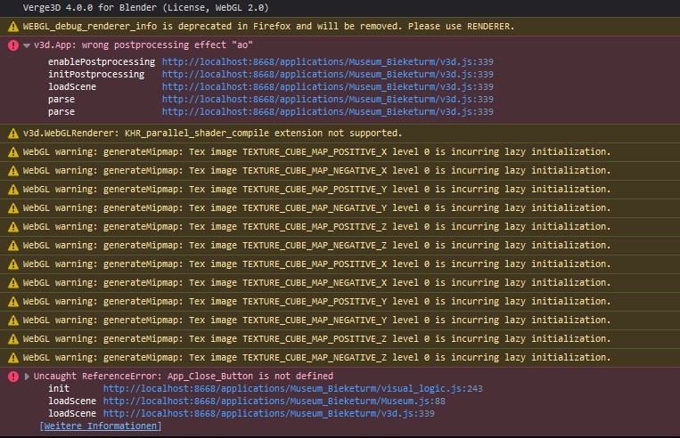

    Hi, is there something in the browser console (press F12 and switch to the console tab)?
    #53133
    This is the output from the browser console:

    Hi, it looks like the puzzles editor incorrectly generated the visual_logic.js file. Can you share the visual_logic.xml file from the project’s directory?
