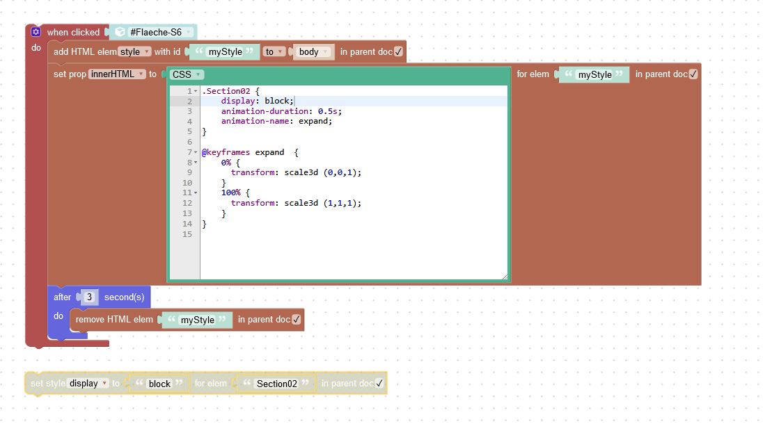

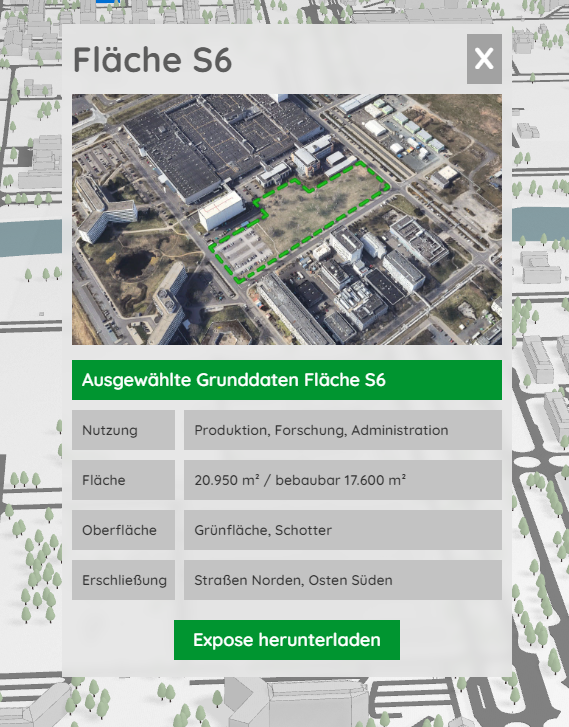

The goal is that I click on a 3D object and a window pops up that has a transition animation (scale, opacity etc).
Now I have a concrete problem that I do not know how to design transitions when opening windows within puzzles.
Attached is an attempt of a puzzle where I tried to copy Html from Webflow, but it didn’t work.Here is the example of how I want it and what currently works :)

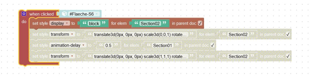

You must be logged in to view attached files.2023-05-10 at 11:40 am #63643Yuri KovelenovStaff2023-05-10 at 4:04 pm #63652vjecht169CustomerHey,
thank you for your reply…I tried to adapt your puzzle, but unfortunately it didn’t work …

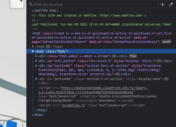

Attached you´ll find my puzzle and a screenshot of the html (with F12)
Here you see, that Section02 is grey…What am I doing wrong?
Best
You must be logged in to view attached files.2023-05-10 at 11:12 pm #63655kdvParticipantWhat am I doing wrong?
you’re making mistakes
remove spaces between
scale3d
and arguments. And in your caseSection02
is not a class name. Use.section-2
instead of.Section02

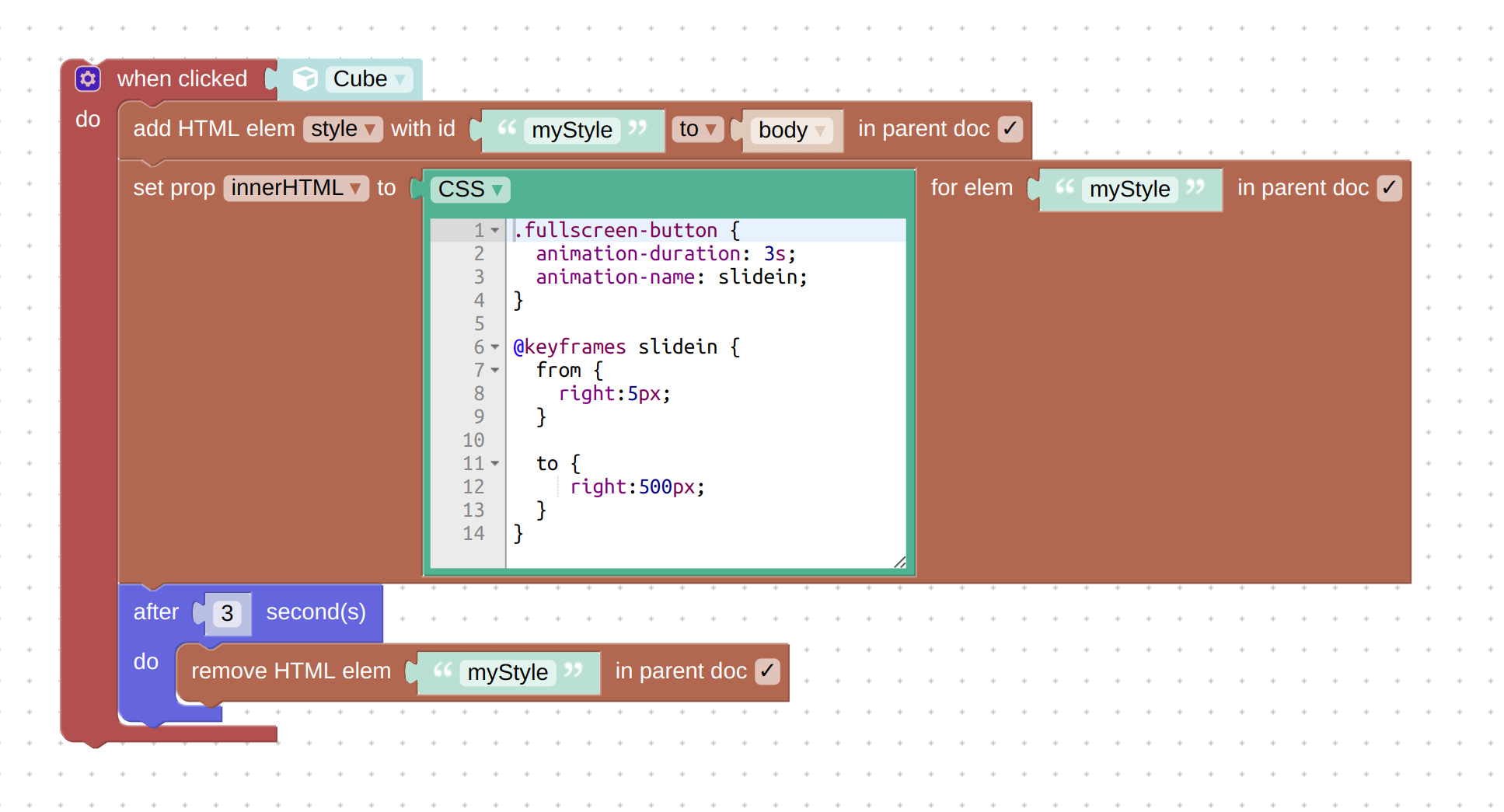

when creating your CSS rule.And you should use this puzzle before starting the animation to show the window

Thanks again.But now I have the problem that when opening the window via the green area the first time everything works wonderfully. The window remains until I click on X.
The 2nd time I click, the window opens, but does not remain and closes again immediately ?
