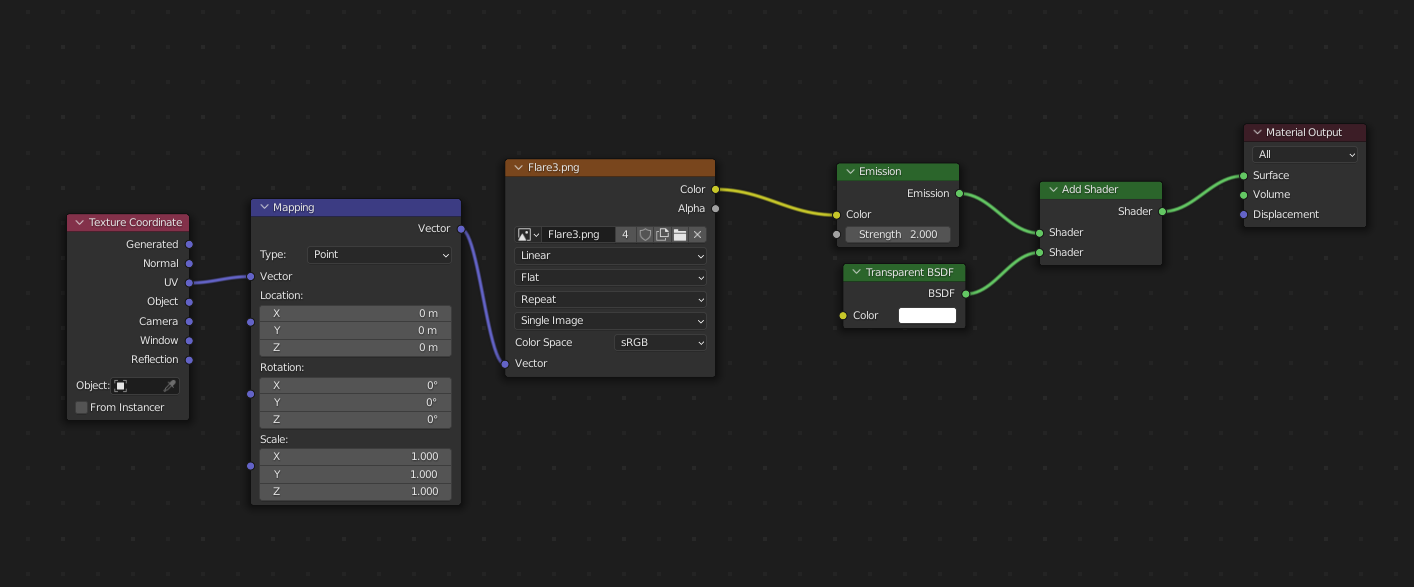

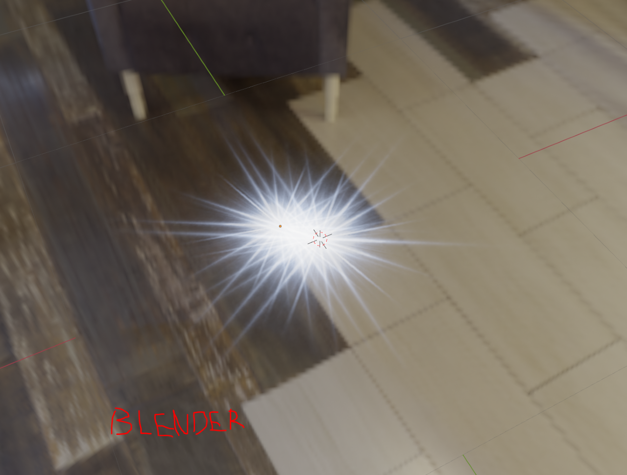

    But we see difference between Blender and Verge export:
    [shader.png]
    [blender-output.png]
    [verge-output.png]

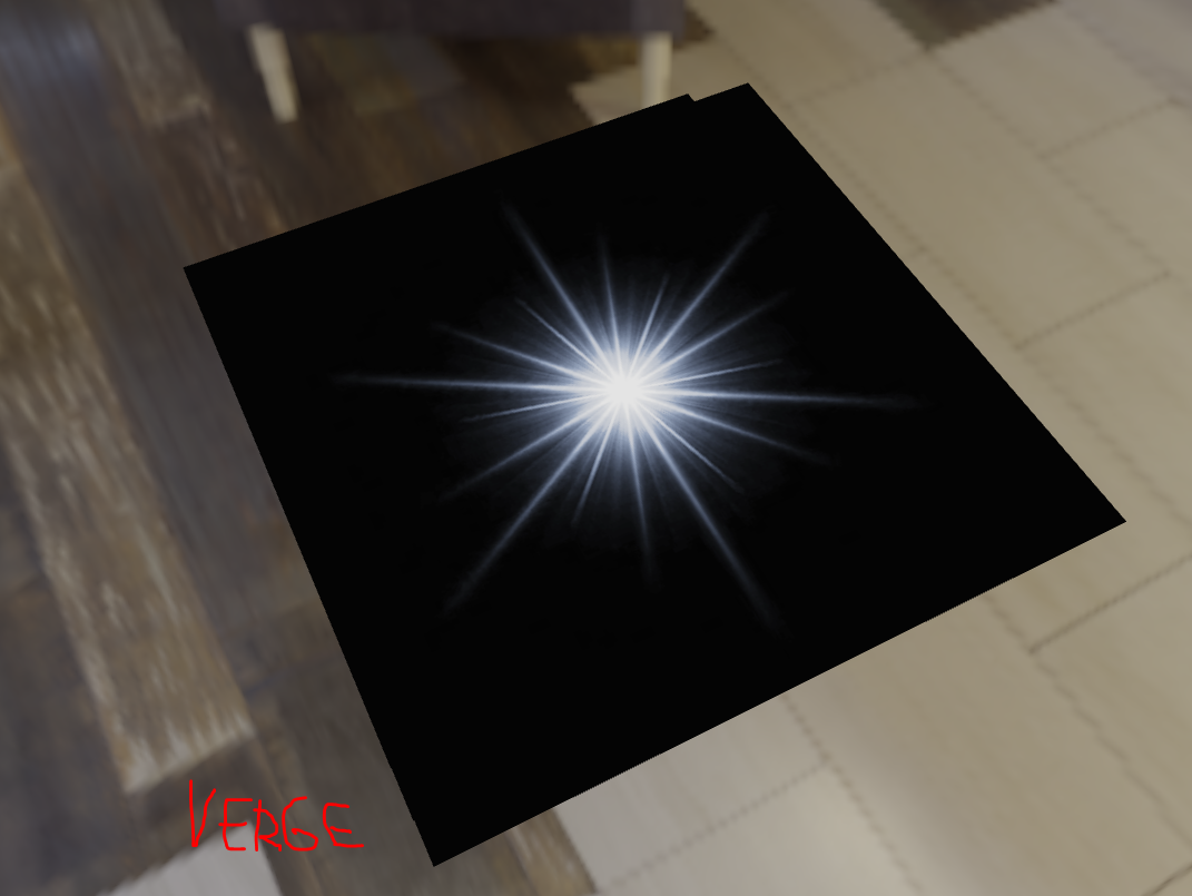

    As you can see, we get only black output in Verge.
    We have also tried different mapping with alpha channel (not emissive) without luck.
    We would like to have additive blending like in first picture. Please can you help me achieve it? I know it was directly in OpenGL drawing settings.

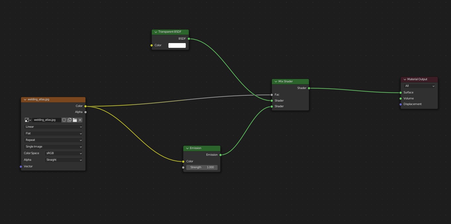

    unfortunally, this combination of nodes not supported. Try mix instead of add mix and blend type of transperency.
    #57118
    precismo
    Thank you for your response. Is there any other way how to achieve additive blending? I remember that openGL itself supports it.
    #57119
    Try this setup with blend.
