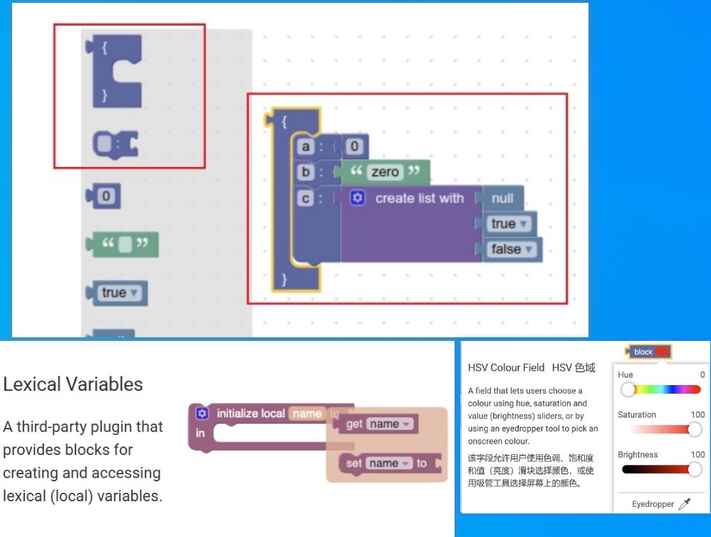

I saw some great block plugins today—I took screenshots of themThings like {} JSON blocks, executors with local variables, custom color input blocks… these are pretty low-level implementations.
Do you @Adam @Alexander think it’s possible to develop and implement them?

I looked into this, and I feel like all three of these are doable. The easiest one would be the color input block. I already got a working prototype. I will refine it and share it soon.
I am curious if you could describe where you feel JSON blocks and local variables would help you the most?

QiangGeParticipantI am curious if you could describe where you feel JSON blocks and local variables would help you the most?
I tried a pretty tricky approach and ended up implementing two versions. Using{}objects is way more convenient than the dictionary blocks—earlier in my project, I had to use dictionaries to save complex data, and it was really clunky.
For the HSV blocks, I haven’t implemented the color picker feature yet, but maybe you have a better idea.2025-08-26 at 3:03 pm #84290adamabr

I tried a pretty tricky approach and ended up implementing two versions. Using {} objects is way more convenient than the dictionary blocks—earlier in my project, I had to use dictionaries to save complex data, and it was really clunky.
For the HSV blocks, I haven’t implemented the color picker feature yet, but maybe you have a better idea.That is sweet! Keep at it! It is best when the person who feels the need for a certain plugin can make the plugin because they know what they need. I am happy we are getting some improvements made here!
