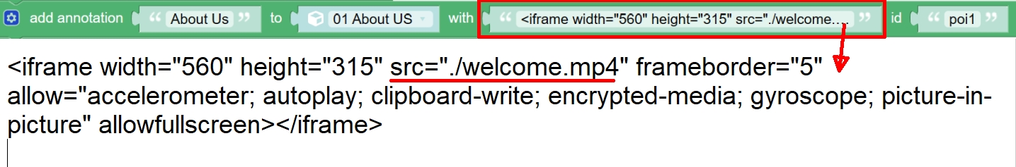

    After long time with the recent version 4.1 I created an annotation with direct video link from the local directory. as shown in image attached.
    The problem is whenever I run it instead of playing in view port it asks downloading from browser. But the URL video such as youtube runs well.
    Why is it happening? is the recent version having different way to do it?

    wrong iframe src
    the iframe source should be an html file containing the following code
    <html>
    <body>
    <video width="320" height="240" autoplay>
      <source src="movie.mp4" type="video/mp4">
    </video>
    </body>
    </html>
