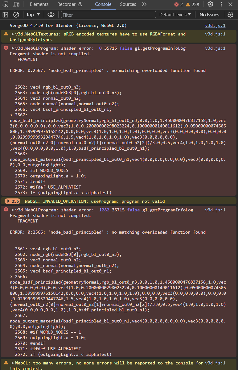

    My assets exported from Blender 3.x were working fine, but when I exported a gltf model today with Blender 4 using the same file (same models, same materials), I started getting this WebGL error in the web app:
    v3d.js:1 v3d.WebGLTextures: sRGB encoded textures have to use RGBAFormat and UnsignedByteType.
    G @ v3d.js:1
    v3d.js:1 v3d.WebGLProgram: shader error: 0 35715 false gl.getProgramInfoLog Fragment shader is not compiled.
    (see screenshot for full error)

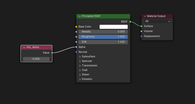

    The 3D models no longer show up. The materials are all basic Principled BDSFs – nothing special besides an input node driving the opacity in the web app (see screenshot).

    I have run into this recently. Blender fundamentally changed the BSDF shaders from 3.x to 4.x and you will have to update it to a 4.0 BSDF node for it to work properly. Its been a while you can try it and see if that solves it. I also believe there were some other shader nodes that got changed, color mix, emission and something else….but try rebuilding your shader nodes in 4.0.1 replacing the 3.x shaders with newly built 4.0 shaders and I think the problem will go away.
    Try it out on one object and see.

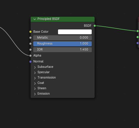

    I went through all the node trees for each material, created a new Principled BDSF Shader node, swapped it in the node tree with the legacy one, deleted the legacy Principled BDSF node, and reconnected it into the node network. Saved and reexported, but the issue persists, sadly :-(
    Could I be missing a step? Surprised more people aren’t running into this issue, so might just be my unlucky setup?

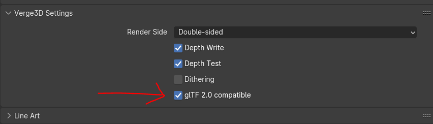

    There is a v3d checkbox setting for each material called “glTF 2.0 Compatible” that was left unchecked by default for me. Checking it on and reexporting seemed to have solved the issue, but need to check later if anything else broke and/or this is a false positive.

    I installed the latest version of V3D (4.5.1)
    But you didn’t update your app. Your app is running with v3d.js 4.4.0 :scratch: And the result is quite expected :unsure:

    …yup, you are totally right. I completely missed that crucial step when updating this time around >.<
    Learned a bit regardless, and thanks for calling that out.
