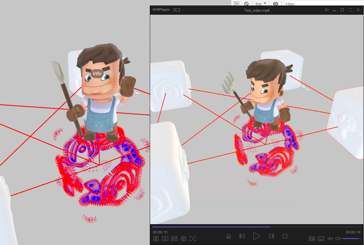

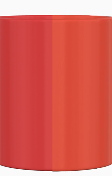

    #62149
    cbcl4655
    Yours looks exactly the same. I wonder what I am doing wrong. The left is the color from the take screenshot puzzle and looks the same as the viewport. The right is from the captured video.
    I’ll have a look at my puzzles and page and see if I can figure out how to get them to match.
    #62151
    I would say that the left image is oversaturated relative to the right one :scratch: On my screenshot the red color is also a little more red on the left )))
    #62154
    cbcl4655
    Yeah, I hadn’t noticed until someone complained about it. I’m going to mess with setting the brightness/contrast post processing puzzle before the video starts and see if that helps.
