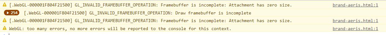

I have been troubleshooting this issue for a while now, and no matter what I do, I can’t seem to figure out what is causing these errors:
[.WebGL-000001F804F21500] GL_INVALID_FRAMEBUFFER_OPERATION: Framebuffer is incomplete: Attachment has zero size.
[.WebGL-000001F804F21500] GL_INVALID_FRAMEBUFFER_OPERATION: Draw framebuffer is incomplete

Yuri KovelenovStaffHi,
this error hints that at the moment when WebGL is initialized, the canvas size is 0 pixels.
This may happen in a dynamic website which starts loading Verge3D app before it properly resized the container element used to include the 3D canvas.
I checked your link it loads for me fine. But there is indication that Verge3D app is initialized twice. That WebGL error is also present. May be you somehow included another invisible zero pixel Verge3D app in the page?

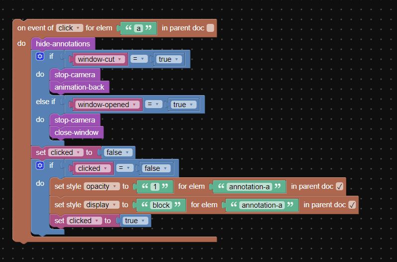

you can see that there are no console warnings or errors, but all my button functionality has broken.
here is how it’s supposed to work:
https://provia.proviaserver-v2.com/windows/brands/aeris/You can see that when you click each element, the annotations no longer popup. See the attached screen shot. I am also including my puzzle xml file if that helps.
