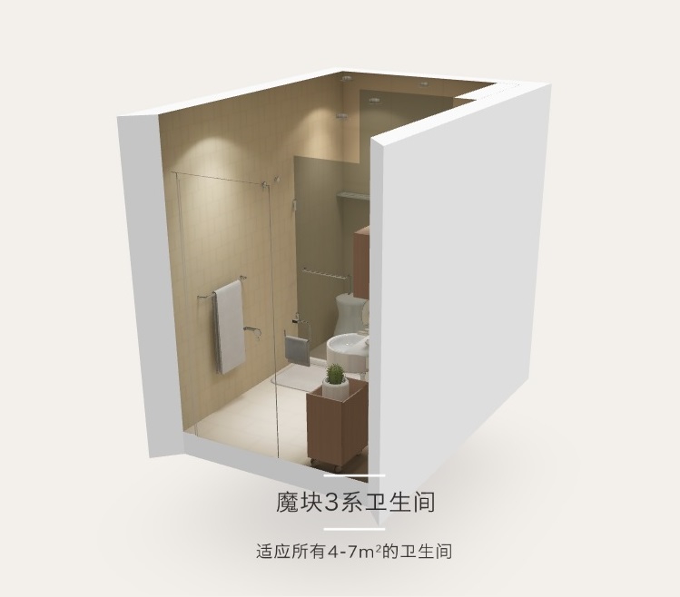

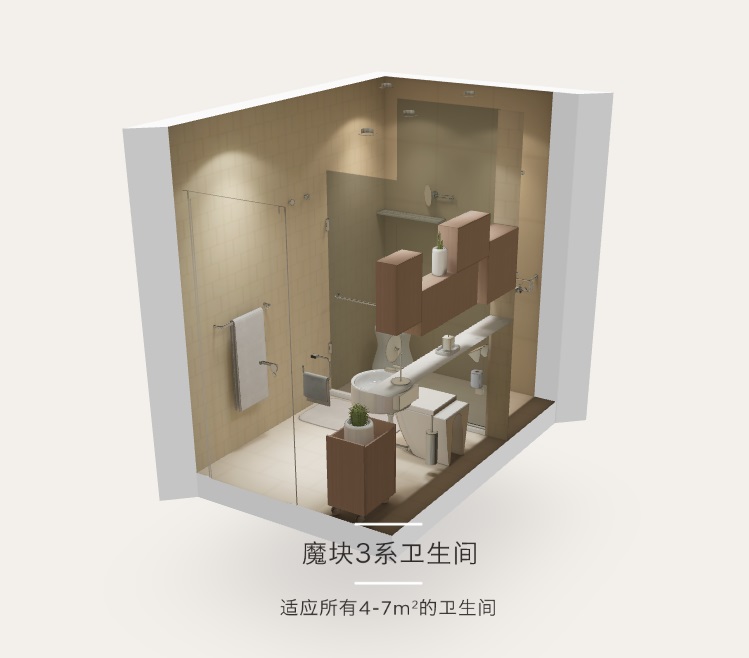

    Hi, I want to create the wall fade effect when framed by the camera, can anyone help me?
    https://cdn.weshape3d.com/km001/1008/web/index.html
