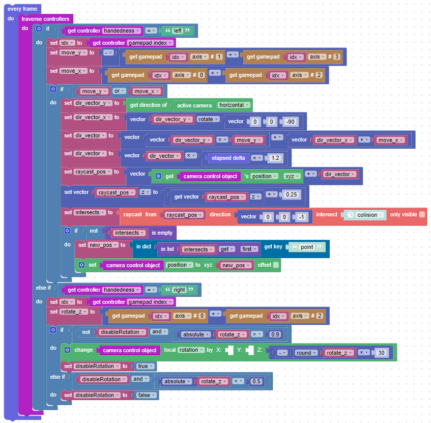

    Simple “collision detection” based on raycasting.
    https://v3d.net/ps8

    #68780
    Reworked VR controls. Can walk on inclined surfaces and stairs. Added rotation like in the home room.
    https://v3d.net/qef
    The First Person Camera demo in VR (with jumping and crouching)
    https://v3d.net/ec5

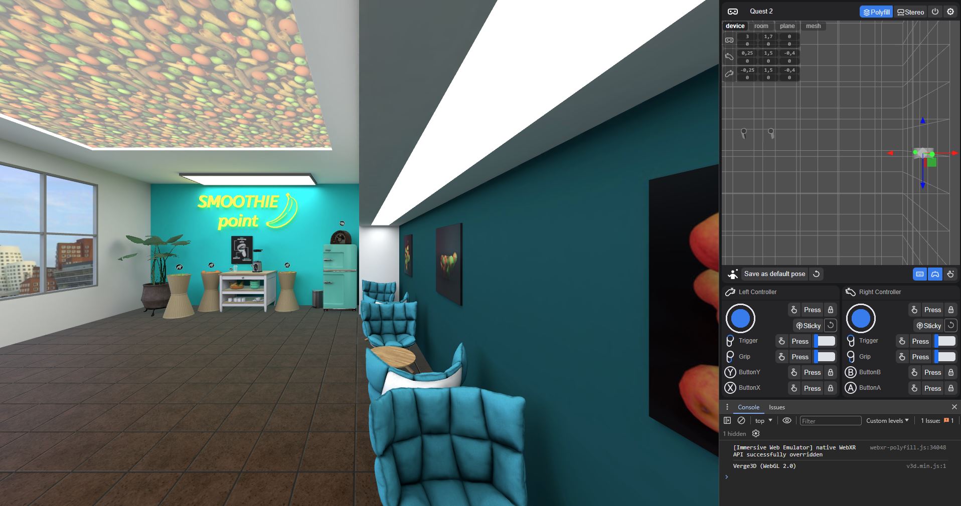

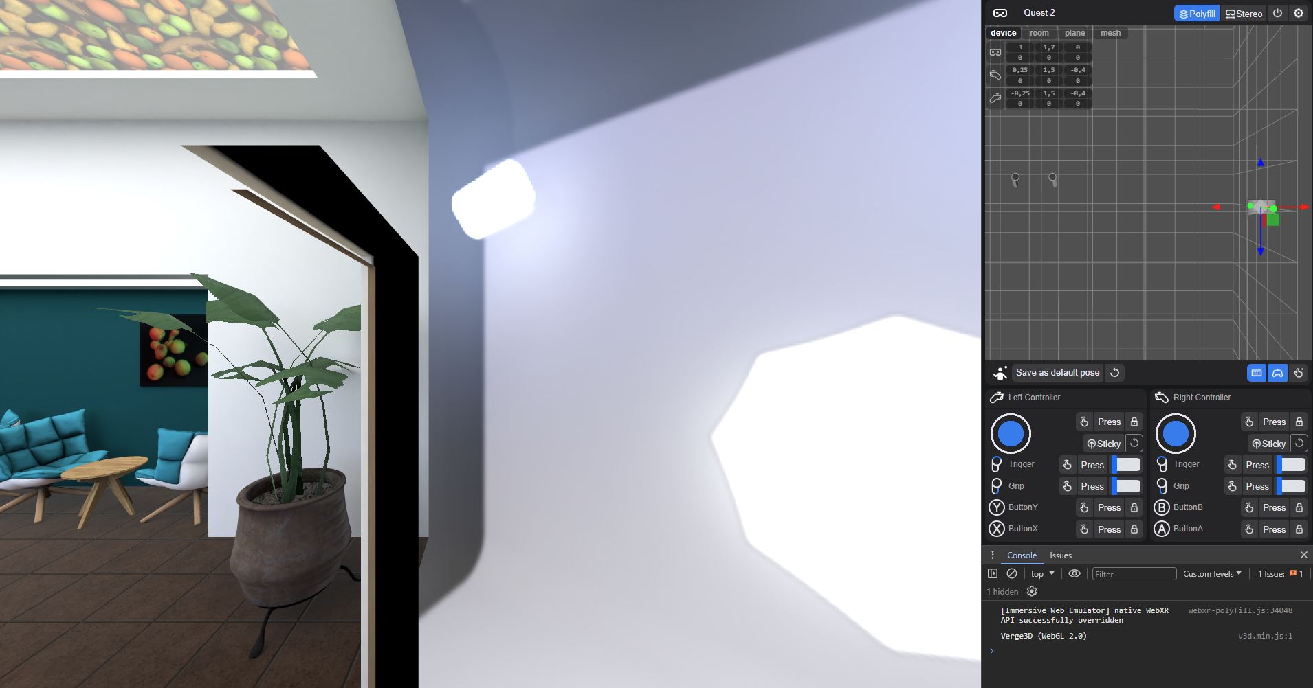

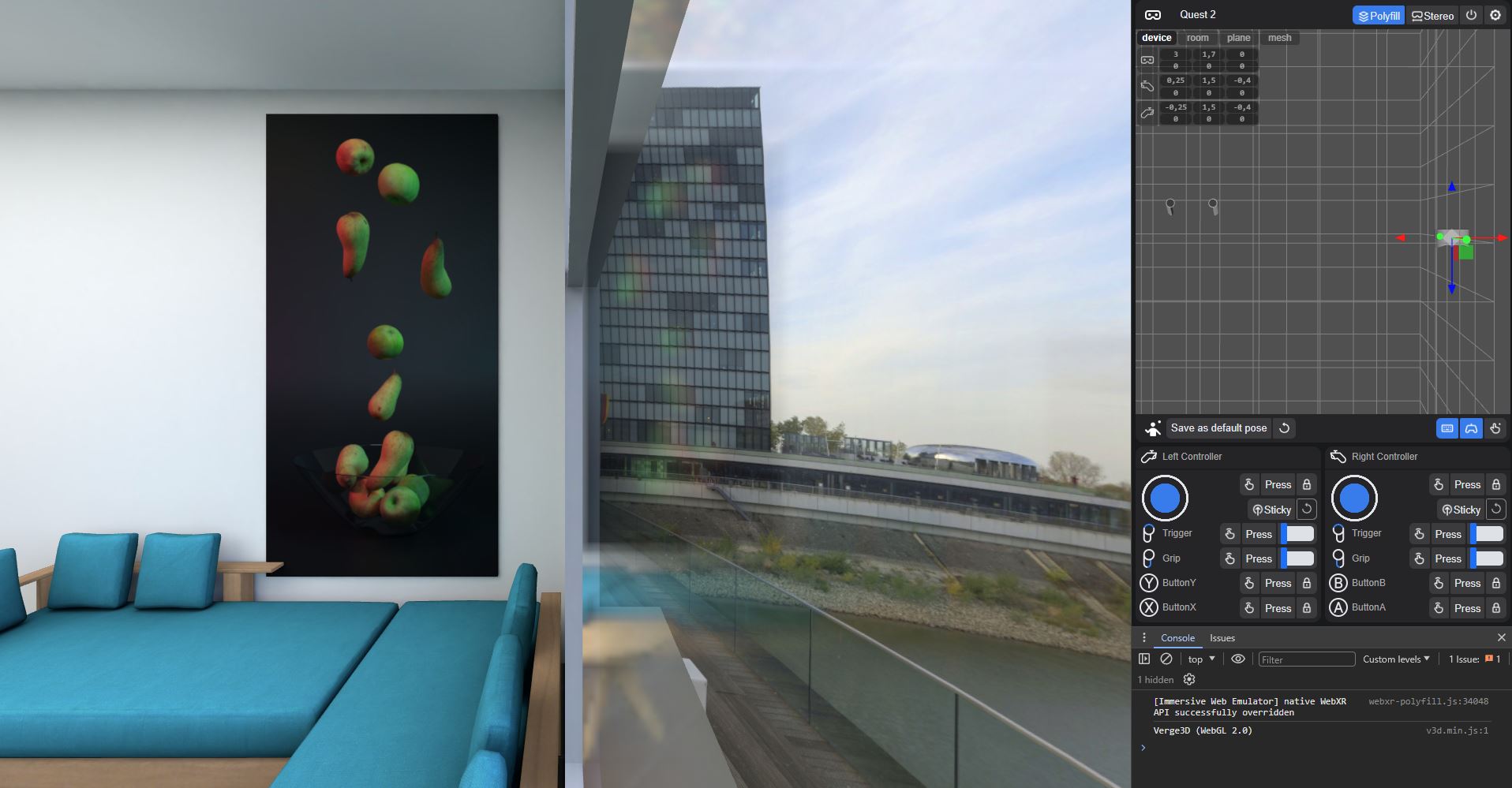

    Thomas Fabini
    Start in https://v3d.net/qef VR mode with the headset offset 3m to the right (virtual_reality_1_VR_offset_3m_right.jpg).
    Rotate the view 90 degrees to the right (virtual_reality_2_VR_rotation_90deg_right.jpg).
    Rotate the view 180 degrees to the right (virtual_reality_3_VR_rotation_180deg_right.jpg).
    In https://v3d.net/ec5 it seems to be just the same. Offset the headset by 3m left on the green, rotate 180, you’ll end up on the right side of the pathway on the green.
    It happens only if you physically move the headset away from the point it was initialized when entering VR. Movements with the stick, where the camera control object coordinates get updated, are not affected.
    In my setup it is even more obvious since I am using continuous rotation. The farther you walk away from the starting point, the worse it gets. You start rotating in larger and larger circles.
    I assume, when walking in VR, without using the stick, the camera control object position doesn’t get updated. So it’s last (known) position in 3D space is used for the rotation.
