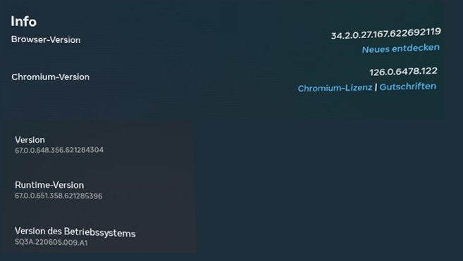

    Attached the following OS and Browser Versions I am running
    Thanks
    Tom

    #76399
    tomtm
    Just let you know that I get rid of these strange bug.
    I bought another Meta Quest 3 —- same bug….
    So I couldn’t believe that, made a factory reset and registered the glass on a completly new
    account. The bug was gone…..
    So there must be something in the settings which will be synrchonized if you use the same account which makes this flickering in .mp4 Videos….
    very very strange….. but it’s solved now….
