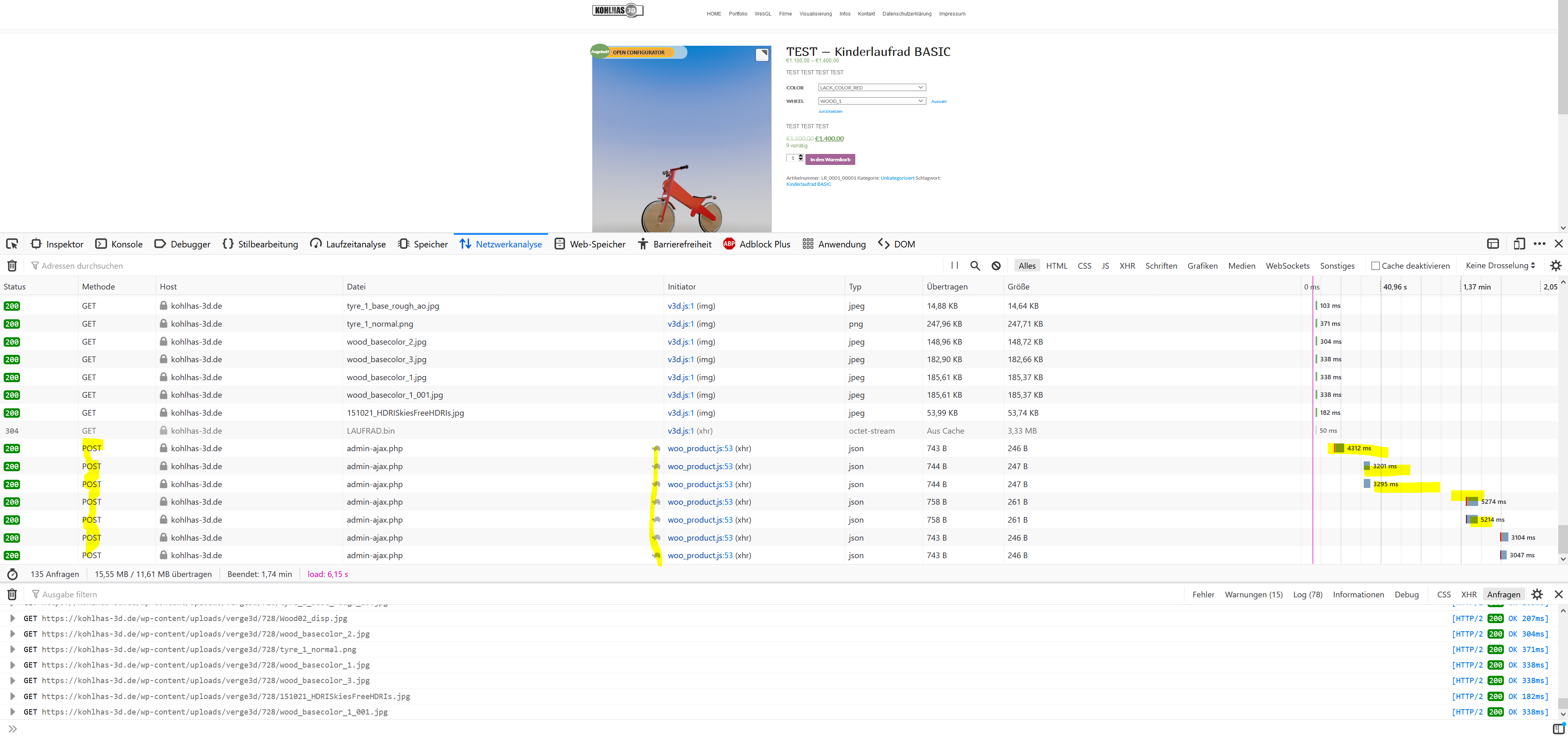

CustomerHere is the test implementation with WooCommerce:
https://kohlhas-3d.de/produkt/kinderlaufrad-basic/?preview=true

But as soon as I have integrated the configurator in WooCommerce, there is this long timegap, so after changing the color the customer has to wait 1.2 – 1.5 seconds until it is displayed.It will probably be because of the POST at admin_ajax.php (woo.product.js). I was already able to pull this down a bit, but unfortunately this is not implementable like this, I’m not an expert in it though. On the internet I found some things on the website (https://onlinemediamasters.com/speed-up-slow-woocommerce-store/), which reduce this gap significantly (among others Cart fragment) .
