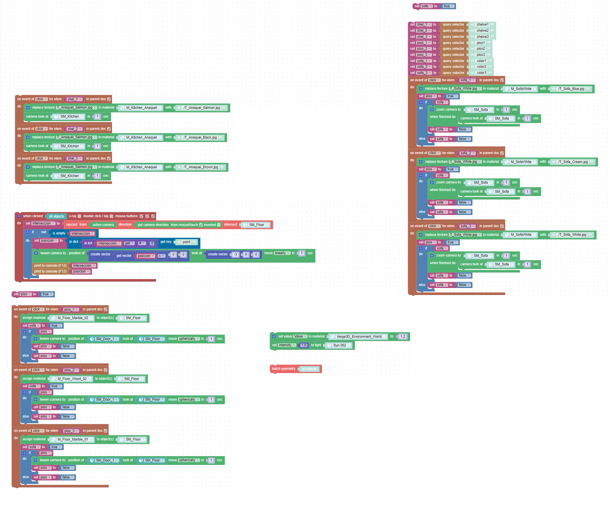

    Background:
    1) We made the scene. [Pic1]

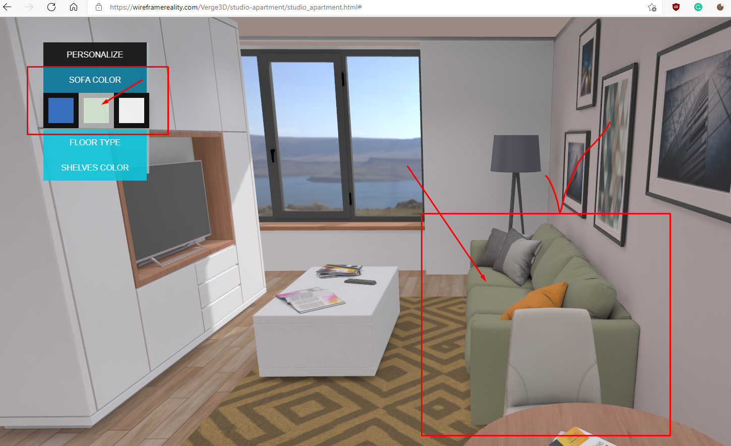

    2) We uploaded it to our server. [Pic2]

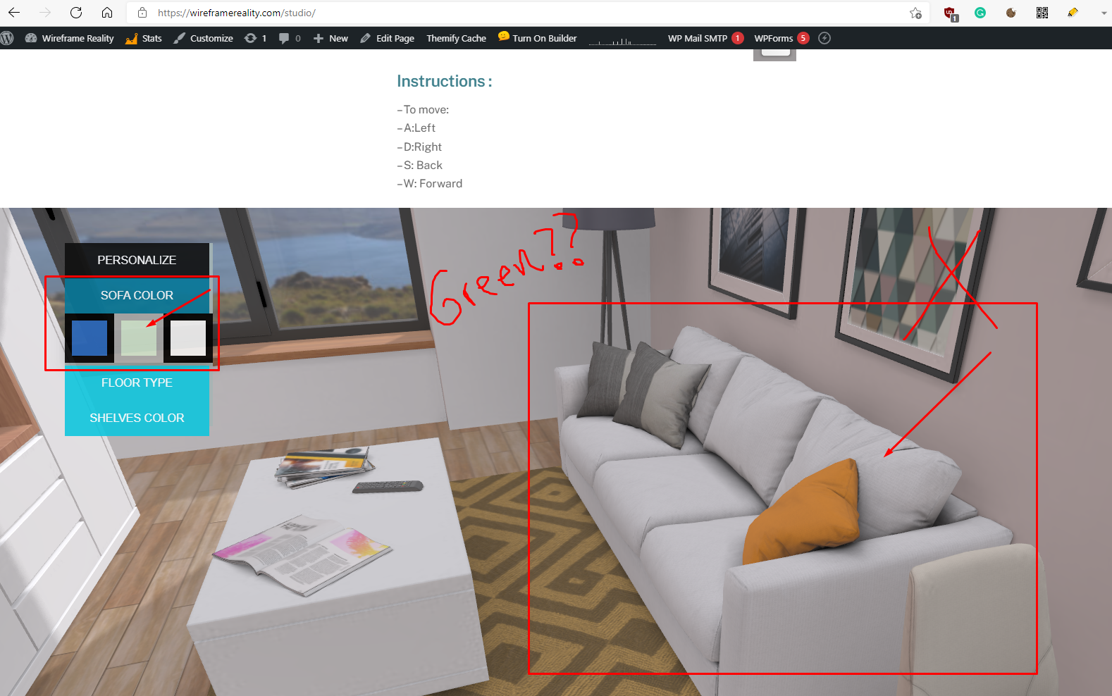

    3) See the configuration. [Pic3]

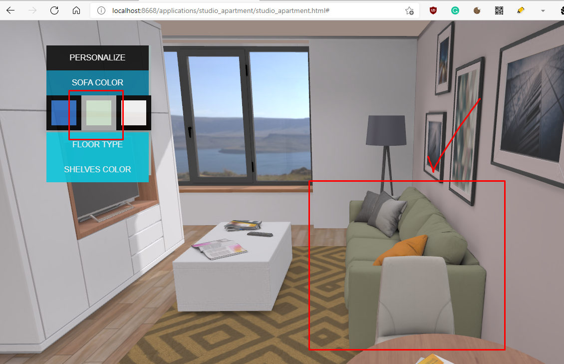

    4) Buttons work in the localhost. Sofa color → Green, turns the sofa to green. [Pic4]

    6) Buttons do not work if called by an iframe. [Pic6]
