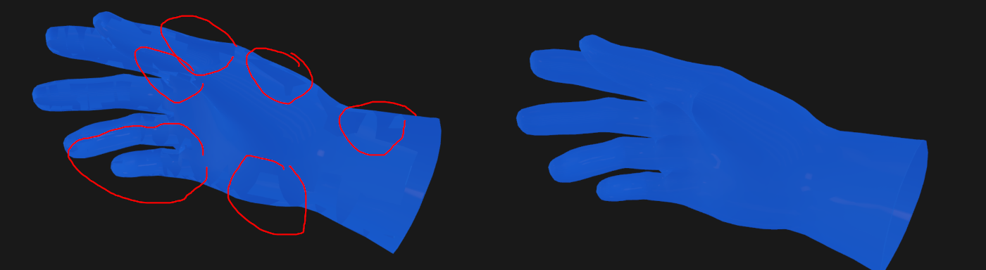

    I’ve checked the mesh, it’s all ok with it. The problem not in depth write and zero faces but because of not sorted faces in trancperency mode. Try to enable Order-Independent Trancperency in Verge3D settings from Render tab or use Alpha Hashed transparency mode: it will render the color not so correctly but you can get a good transparency without issues. It helped me to fix all issues in your scene.
    #76907
    Thomas Fabini
    Thank you very much for testing this, Mikhail.
    I’ve tried this now, too, with a similar but clean mesh with no zero faces and the problems with depth sorting are just the same.
    I’ll try alpha hashed, too – I tried to avoid it, mainly too prevent Quest 2 / 3 performance drops on heavier scenes.
    #76910
    Maybe we talking about different issues. After I set Order Independent transperency after export mesh turned out clean.
