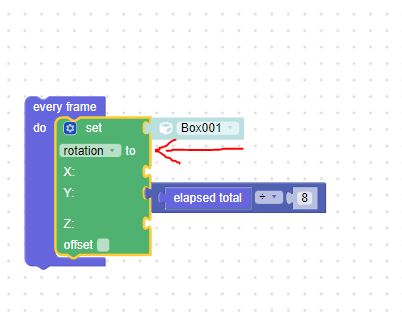

2023-02-10 at 9:47 am #60281amirferdos
Participantplease check the set transform Puzzle, it is not working in rotation mode.
Thank you
2023-02-10 at 10:25 am #60285kdv
ParticipantTo change rotation you should enable the
offsetoption. Your logic sets nearly the same angle every frame so you do not see changes.Puzzles and JS coding. Fast and expensive.

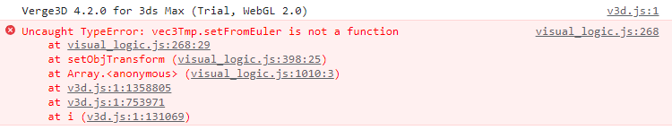

Alexander KovelenovStaff2023-02-10 at 12:44 pm #60289amirferdos
Participantplease check the project, I think the problem is looking to (set transform

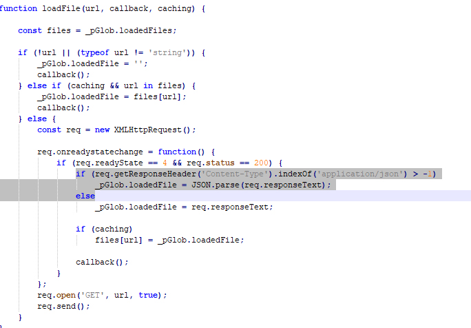

2023-02-10 at 4:20 pm #60293michele tamborino
CustomerHello everyone, I need to solve this problem. In order to read json files after version 3.8 I need to remove at each save these lines from visual_logic.js
if (req.getResponseHeader(‘Content-Type’).indexOf(‘application/json’) > -1)
_pGlob.loadedFile = JSON.parse(req.responseText);
else
How can I get around this problem? Thank youAttachments:

2023-02-10 at 8:13 pm #60296kdv
Participantplease check the project, I think the problem is looking to (set transform Puzzle)
v3d.js4.2.0 used in your app is not fully compatible withpuzzles.min.jsfrom 4.3.0pre1. They changed theeulerV3DToBlenderShortestfunction. That’s whyset transformpuzzle throws an error.
Replacev3d.jsin your app’s folder with the latest version.How can I get around this problem? Thank you
remove this code from
puzzles.min.js

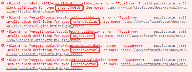

https://www.soft8soft.com/topic/verge3d-4-1-1-maintenance-update/page/2/#post-55525Hi, can you please share the plugin which causes these crashes?
See the attached file. Before 4.3.0pre1 the problem didn’t exist.
