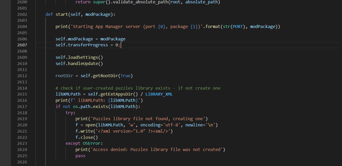

precismoCustomerHi Verge,
during testing Verge3D App Manager I was receiving “permission denied” and was unable to get any demo working even when run as administrator with elevated privilegues and installing to non “Program files” folder (Windows 10).
I found out part of server.py expects that “applications” directory exists but it does not (screenshot attached). When I manually created this directory, server started working properly.
I suggest you add to relevant server.py code which creates applications directory or alternatively this directory should be created empty during installation process.
thank you,
Peter from Precismo

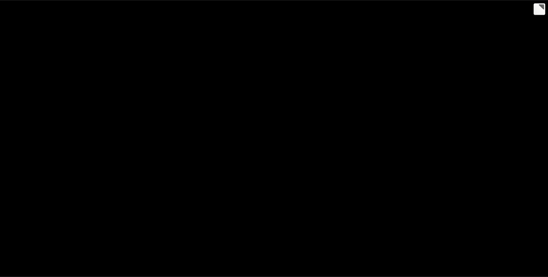

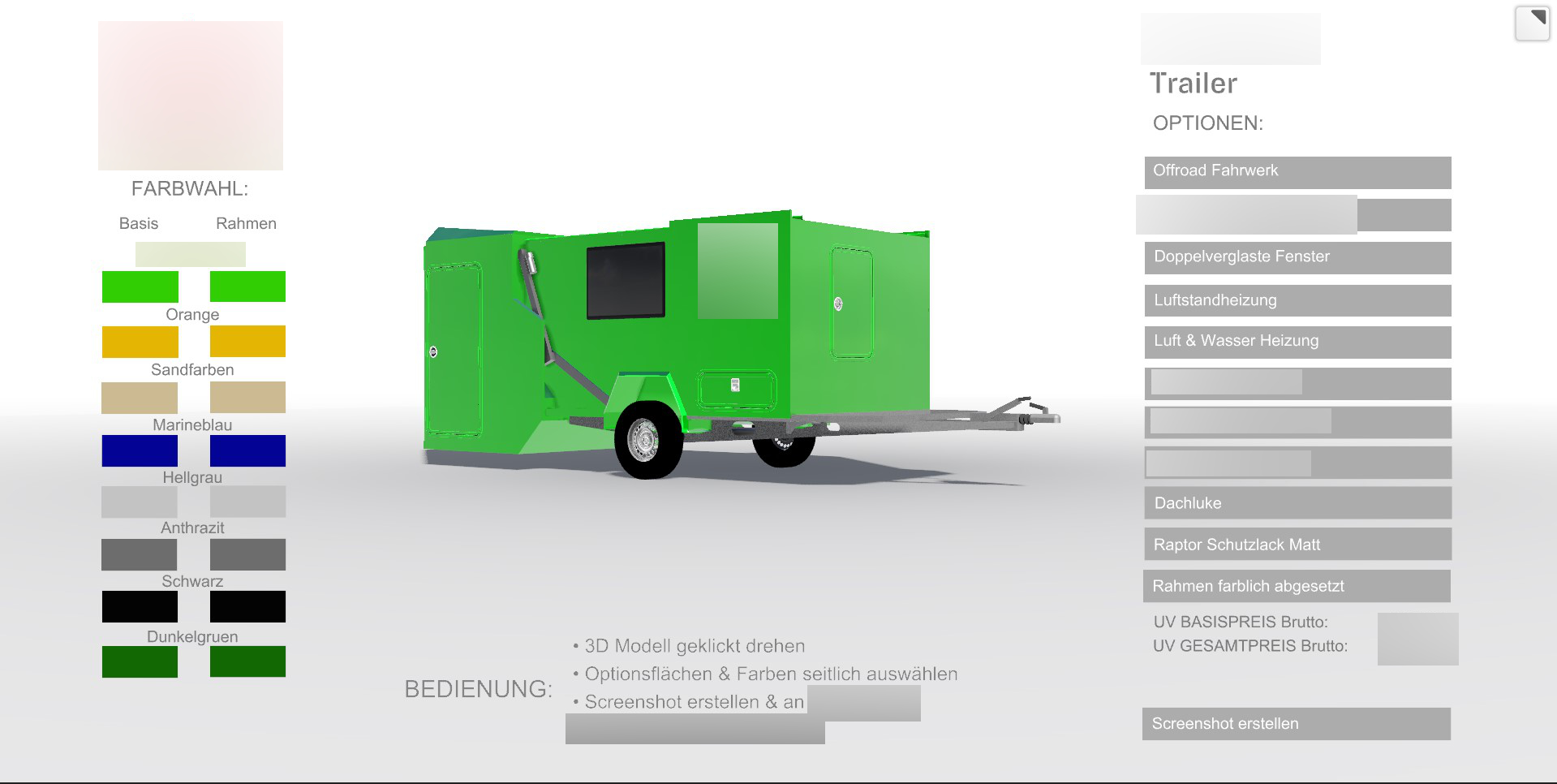

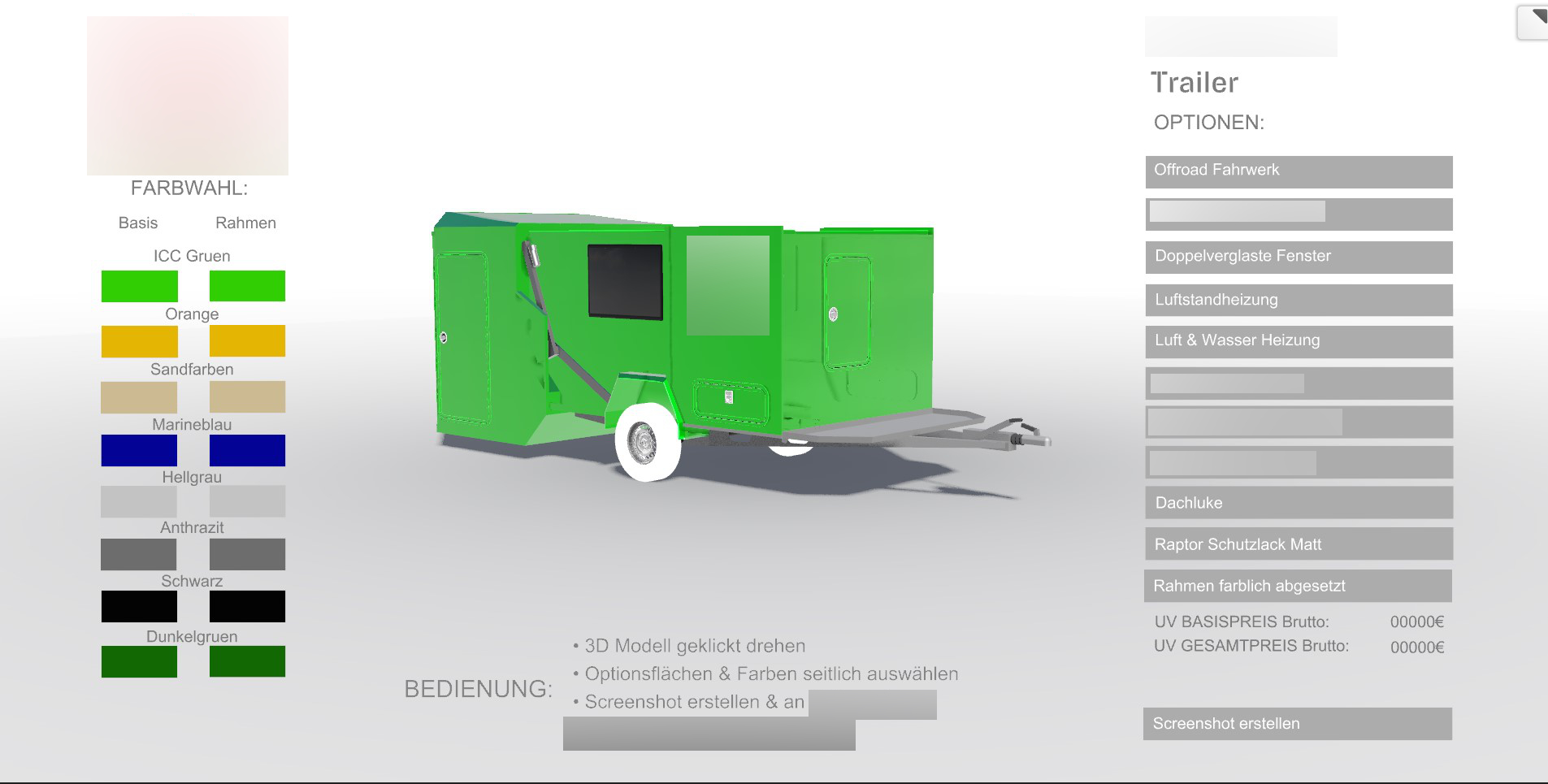

2022-03-23 at 11:01 am #50545prettypicturegirl
CustomerHi,
just tested it with Blender 3.0.
I did start with a copy of my 3.9 project.
This project works fine under 3.9. Correct colors.
Only thing where it does not work is on all Apple mobile devices with iOS 15.4. It does not finish loading there.
On the PC it says framerate is around 50-60.
It works on PC&Mac desktop and on Android (also older devices down to Android 9).Then I uninstalled 3.9 and installed 4.0P2.
When I take a look at sneak preview under 4.0P2, some colors change and all colors show strangely translucent.
When I rewrite the Verge3D file and open the app it stays completely black.See screenshots. Happens after the app was updated.
Under Blender 3.2 I get an error when enabling Verge3D.That is probably to be expected as its not released yet..
Reverted back to 3.9 for now.
