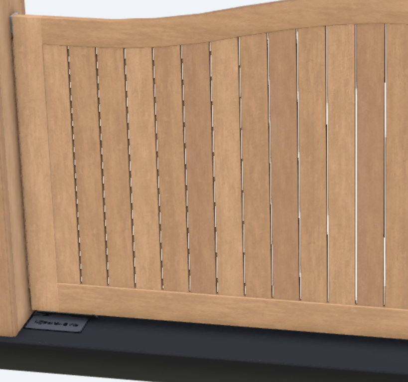

    We are using the new AO, and so far it works/looks very nice. One issue I spotted though is that areas of an object that receive the AO also get most aliasing, which is very apparent. AA is set to auto, but even if I lock it to MSAA x16, the same amount of AO aliasing is apparent. Any idea on how to fix that? My opinion is that this is an issue with the order of how post processing is applied, first AA, then AO, but then again this is something I think and can’t verify.
    Kind regards,
    Dragos

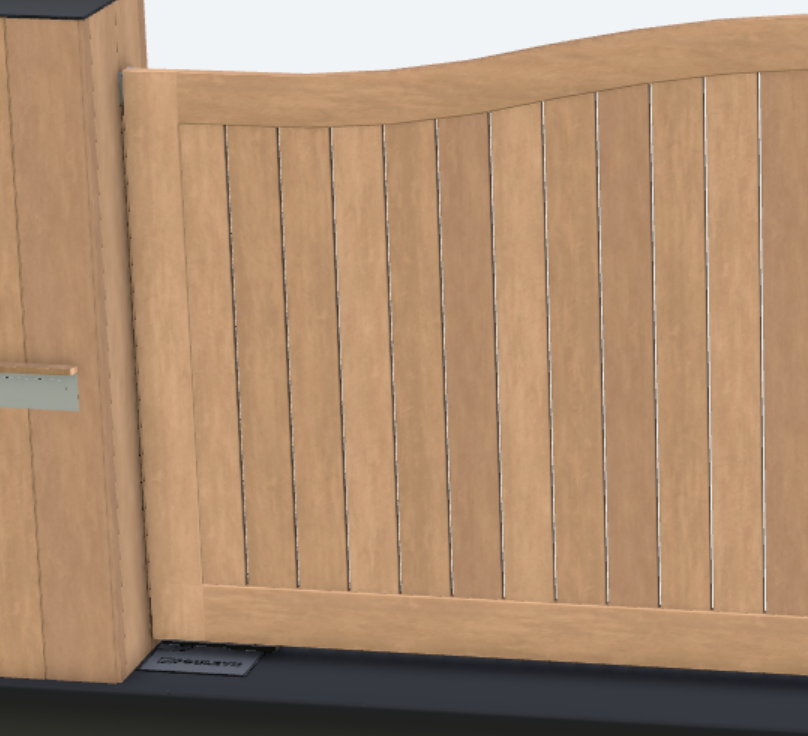

    With FXAA the result is indeed smoother, but still not as smooth as with baked AO.

    Now that I test it thoroughly, I can say FXAA is mildly better for aliasing between geometry, if it’s between geometry and transparent background, aliasing is much harder in the case of MSAA.

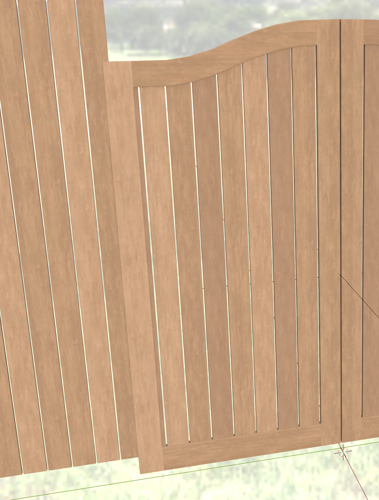

    Yes indeed I am aware of the limitations, but EEVEE does superior AA to it when stationary.
