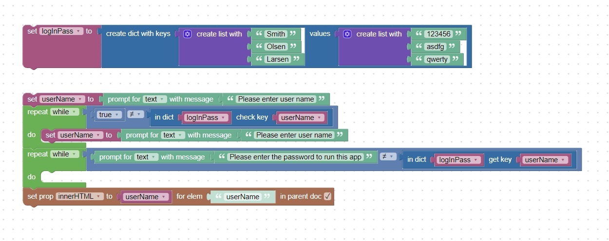

    Pandern
    Thank you, Yuri, for the link on the password protection using promt and while loop, I had forgotten about that.
    Exactly what I was in need of today. I also needed to expand the login to multiple users and different passwords without the need for html authoring.
    The dictionary used will of course be an external file, this just for example if the OP might find it useful
