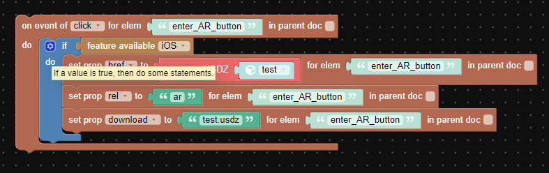

    studiogijs
    I found out the only way to make this work was to wrap the “if feature available IOS” code into a click event, for example see attached.
    I suspect otherwise the export of the scene is not refreshed with the latest data.
