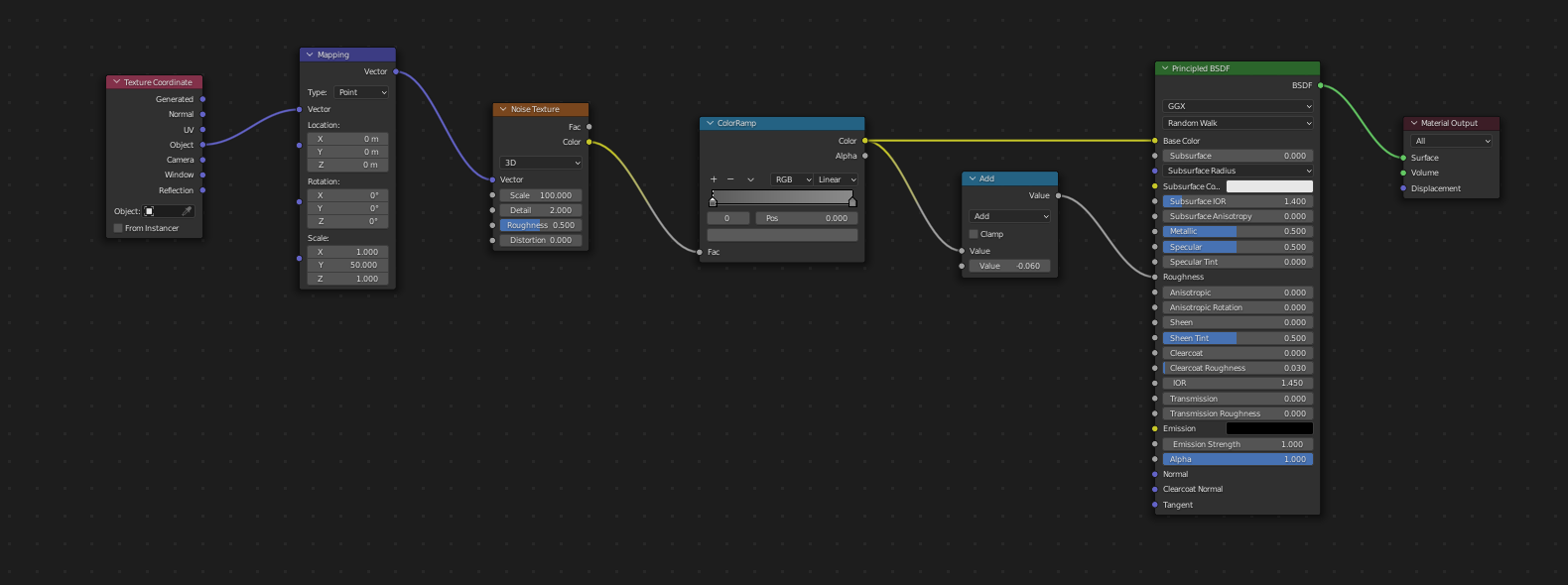

    nsansomw
    I have been trying for find satin stainless for a few years. The attached is the best i have found so far that works for me.
    #49915
    pekkizz
    Hi nsansomw!
    Thank you very much for this!
    I tried it, but it gives me bad noise..
    What could it be? also there is a new brushed metal that they just released today! It is here too, and It looks great too :)
    Here are my settings, only a blue tint on color ramp added:
    https://catchline.fi/toveri/my-satin-steel.png
    Yours,
    Pekka
    #49916
    All solution that uses bump node will poor looking because of WebGl specific.
    #49924
