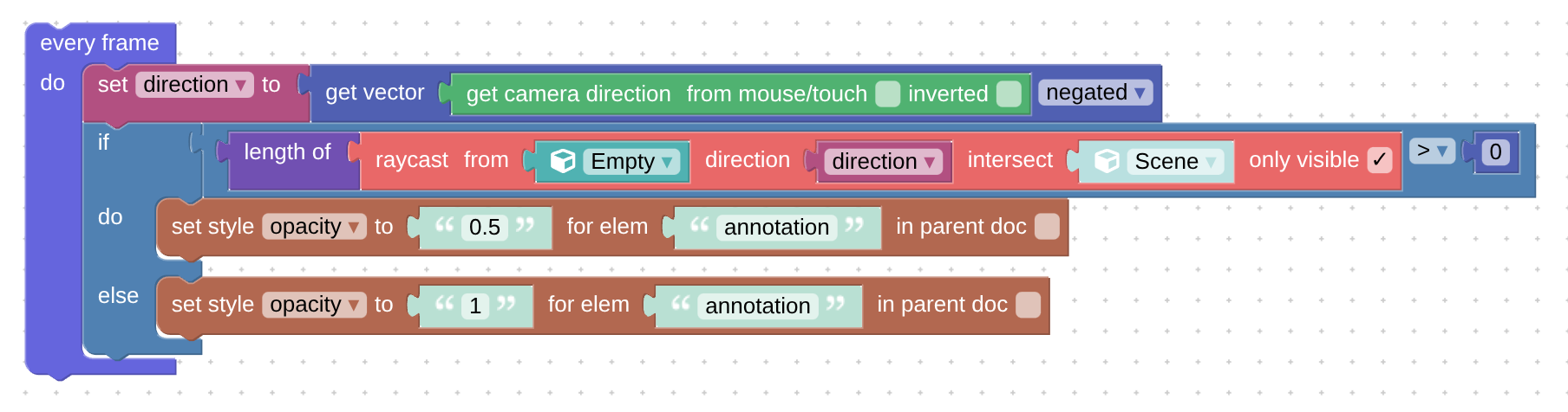

    #81603
    You can use raycast puzzle to cast rays from the camera to the annotated object. If there are no intersections occur, your custom annotation would be fully opaque. If there is some, the annotation would be faded.
