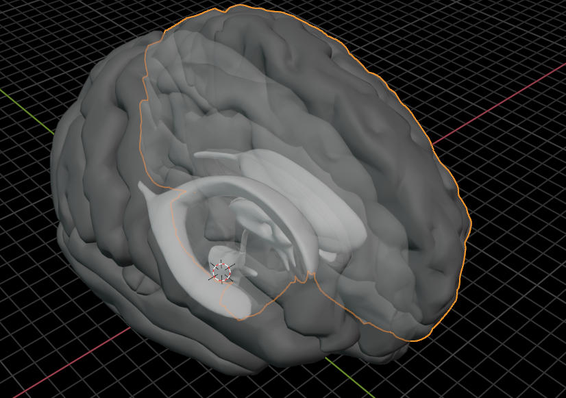

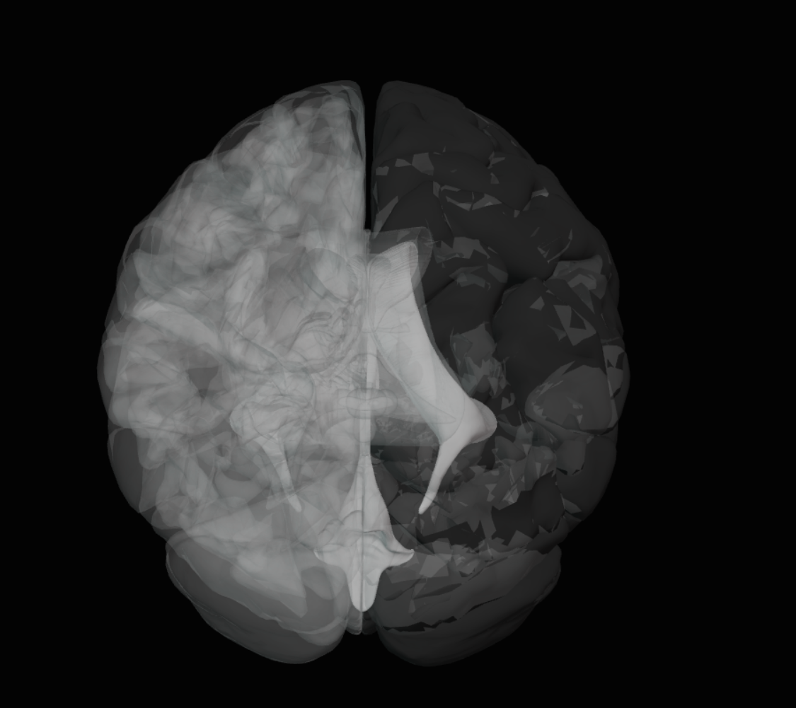

    So I am trying to make a Object in 3D that has a lot of complicated geometry transparent, it works in blender but when I export it to verge it creates a lot of artifacts. I have tried changing things such as Depth Write, Pass index, and z-depth but nothing seems to work.
    Here are a couple of images to show what I mean:
    On the verge object the right object has depth write on and the left one has depth write off (note, when I look at the object from the front there is little to no difference between them)
    How can I make the object in verge look more like the blender counterpart?

    Try to convert all n-gons to tris.

    There seems to be little to no difference when I convert the n-gons to tris. Could it have something to do with all the overlapping geometry?

    Try to enable Backface Culling and disable Show Backface in the material settings panel.

    Well there seems to be no change, I’ve tried just about everthing I can think of or find in the archives, is this a bug with verge?

    Try to disable Depth Write on the material.

    No change
    #39062
    Seems like this issue can’t be fixed right now. :unsure:

    We’ve just implemented an order-independent transparency feature to finally overcome such problems.
