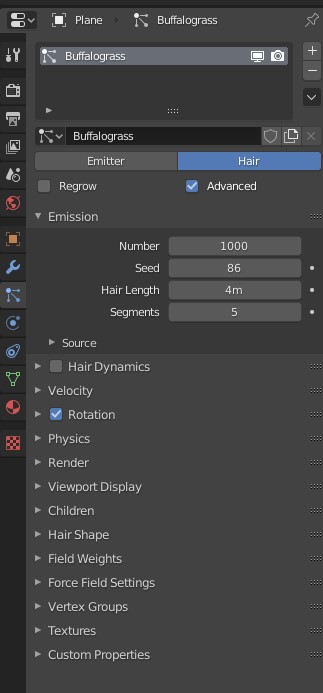

    How do you add it? Using particle system? If so then it’s not supported yet. for hait and grass you can use this technic, it works good for the engine.

    I buy the add-on:Real-Grass on the BlenderMarket.It works very well on eevee rendering.
    But cannot see it on verge3d.
    I think its theory: images as planes

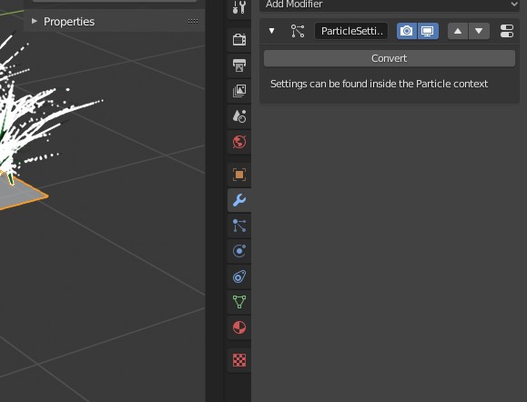

    #15771
    You need manually convert the particle system to meshes and then remove particle system from plane. This will work.

    #49187
    aliamtree
    Hi, i am still unable to see hair on my verge3d, though i have converted to mesh and deleted particle system?
    #49339
    If particles converted to a mesh they must be visible. Can you attach here the file with the cnverted particles and textures assigned to them.
