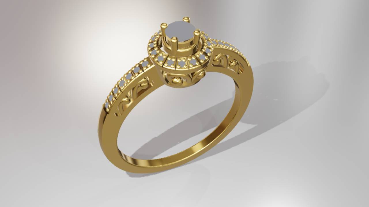

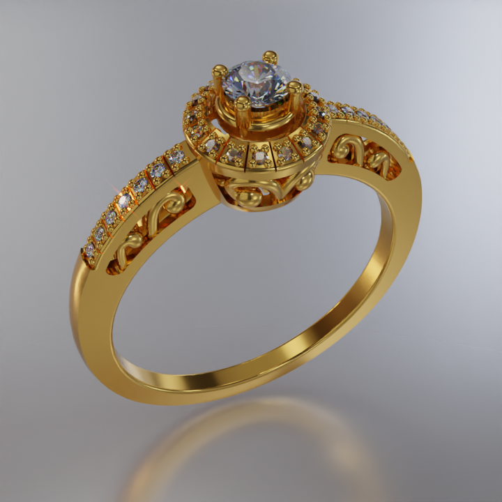

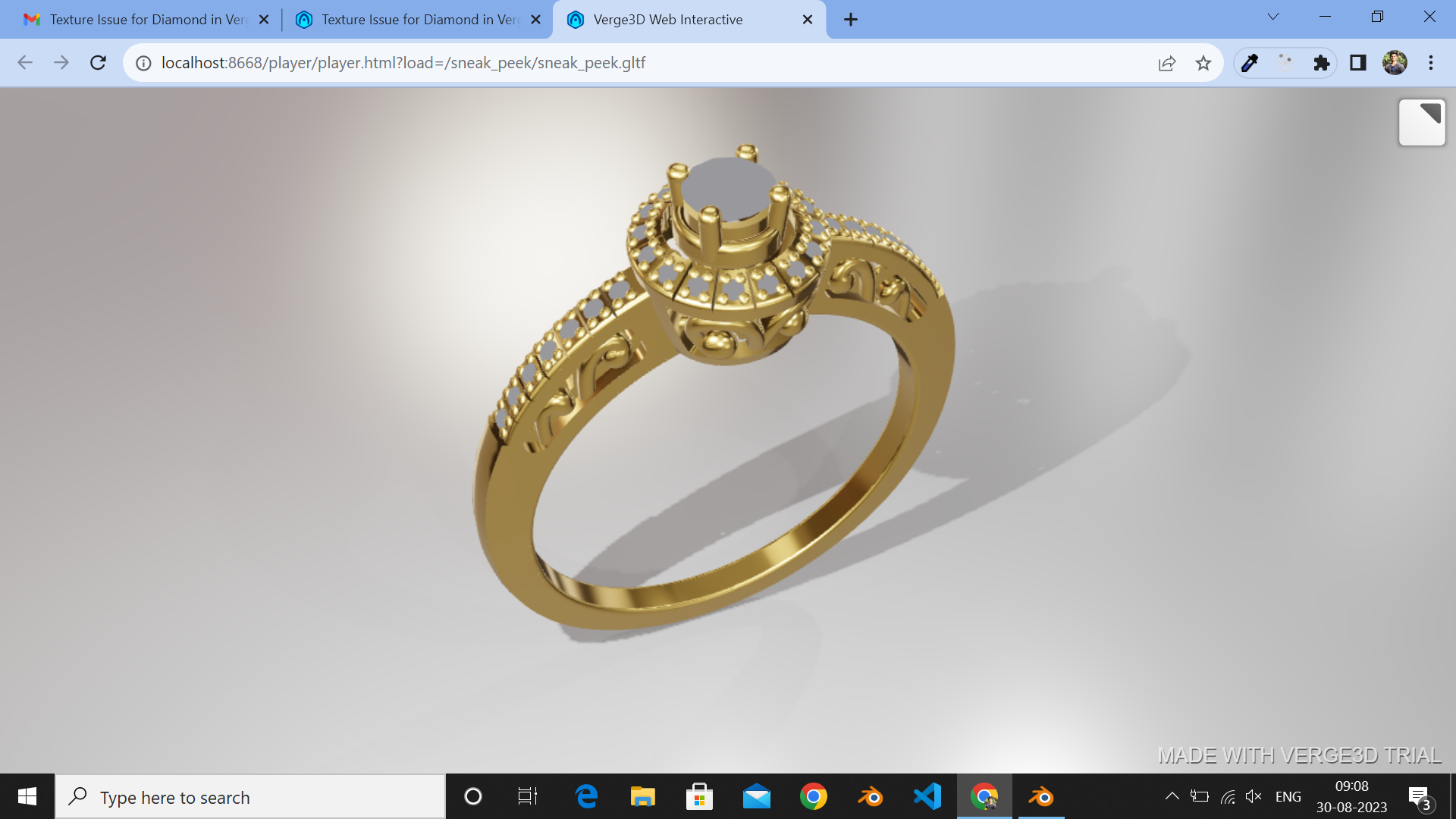

    Hii,
    When i am opening the blend file in verge3d by sneak peek the Diamond Texture is not showing up which nodes i have applied for. Please help me out to get the material texture. (Image Name: verge-3d.jpg)
    And when i am rendering the output from blender i got all the material texture perfect. (Image Name : Blender-render.png)

    In blender Eevee / Cycle it is showing properly Realistic Diamond …..but while opening in browser through verge3d sneak peek….its not showing diamond shader texture.

    In you material remove purple inputs inside the group to make it work in browser. You don’t use normals. But the result will be a little questionable ))) So get rid of your over-complicated material and use the material from the Ring demo.
    Glass bsdf
    This shader is suitable in Blender only, for Cycles. In Eevee and browsers it looks like the Glossy BSDF. Nothing interesting.
