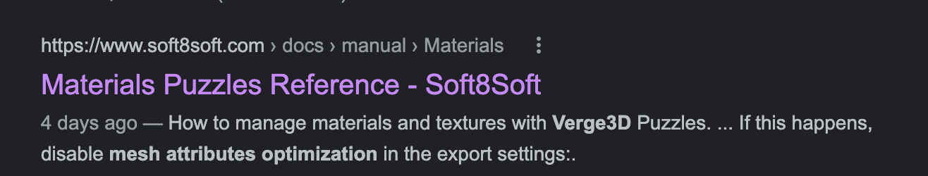

    Hi Yuri,
    Thanks for the info, I would have not guessed that would be the issue. Seems that section of the online manual was just recently updated.
    Could you tell us what the “optimize mesh attribute” really does and what the benefits are of having it on all the time as default vs just having it off as default?
    I am hopeful my memory is good enough so that I remember to check this when I encounter it again but not likely.
