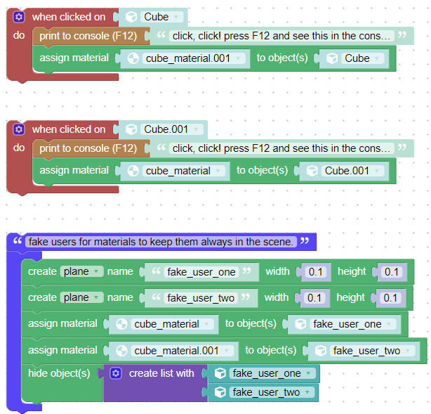

    watch that tutorial again (to the end). with a little more attention. the problem is not in clicking, it’s in materials. Material four is your case.

    When you discover for yourself such a useful debugging tool as the console log it will be much easier to code with puzzles and control every step in case of having problems…

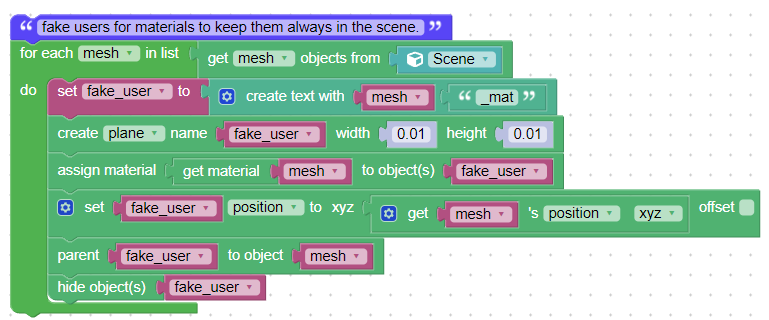

    #72310
    A simple peice of code to create additional material users for each material in the scene. No need to do smth in Blender.
