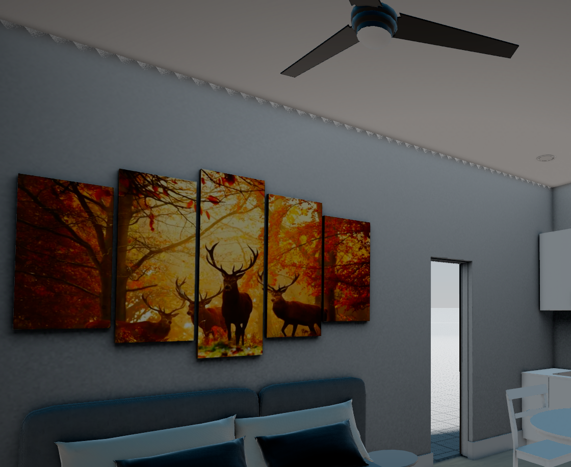

    Hi, I have some shadow artefacts I’ve struggled to remove. (See the attached picture)
    I use a sun lamp. The ceiling is a separate object. Along the seam between the wall and the ceiling I can see light leaking through creating an unappealing effect.
    What settings would you suggest I play with?
    Thanks,
    Adam
    #76337
    My guess is you have Ambient Occlusion turned on? If so try turning it off and see if the artifacts are still there.
    #76341
    shadow map resolution, scale bias, blur radius
    #76348
    adamabr
    Thanks for the suggestions Xeon and kvd!
    What I found:
    – AO did not affect the light leaks.
    – Changing the Sun lamp’s “Max Distance” from 200m to 40m (max distance I’d ever be away with the camera) Solved it! In general, the shadows seem more accurate.
    – Seems like best practice is to keep this as low as possible without causing other shadow issues such as the shadow not appearing when far away.
    – Another thing I have noticed is visible lines between cascades. Setting fade to 0 seems to fix this for me. Not sure what happens here but I’m happy I don’t see ugly lines all over.
    Thanks again,
    Adam
