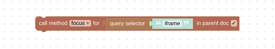

    please make sure you also updated the runtime for each of your apps: https://www.soft8soft.com/docs/manual/en/introduction/Updating.html#Update_Applications_Auto
    Also if your app is running inside an iframe, you need to additionally focus on the iframe element using this puzzle:
