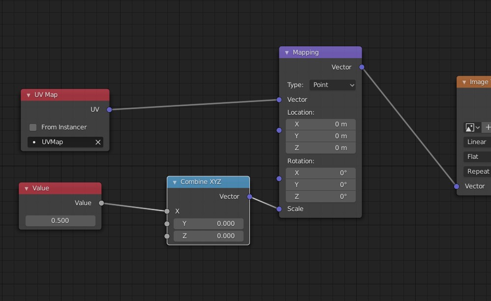

I have a configurator working well using and changing/swapping gltf’s and textures from the parent doc as needed. Problem is on the texture side, they are seamless tiles that vary greatly in size and aspect ratio if keeping to a single repeat for a minimal file size (but they are the same dpi). What is the best way to control the scaling so that, for example,the smaller textures aren’t stretched out, and the larger compressed and/ or distored.
The solution likely starts with the material puzzle for the dimensions, and a calculation can be done on the server side, but not sure how to get it back to verge and scale in a manner like you might with the vector mapping node in blender.
Thoughts? and thanks in advance.(ps could of course already have the scaling values ready (from the server) on selection of a given texture, but still not sure how to affect it in verge).
2020-07-06 at 6:21 am #29694
Mikhail LuzyaninStaffYou can add a mapping node with a value node this way and change value with Set Value puzzle.

Mikhail LuzyaninStaffYou need to turn on Anisotropic Filtering in the image settings. You can find the solution in this video.
2020-07-13 at 5:01 am #29998swatchyb
CustomerThanks for the tip and video link Mikhail – worked great. think i’ve got the scaling with the value thing figured out too, though not fully implemented.

CustomerAlso, on the texture scaling question, I have this puzzle that works if I put a constant for the set value to part, or send value from database, but I wanted to derive the width from the external jpg and calculate the scaling factor based on the difference to the original/stock texture as attached. Is this possible, or what am I doing wrong to get the mat1 width and make the calc vs the 512 original.
As well, even with a constant, it works on mat1, but not on 2 or3 etc. The xy “value” can’t be made unique in blender, or verge doesn’t see if I change the title of the value, so do you have a suggestion.
Thanks very much for your kind attention.
2020-07-14 at 6:46 am #30088
Mikhail LuzyaninStaffthe primary background scene loads, but none of the assets/ other gltf’s. I had this problem once before on the ipad, and it mysteriously went away, but now back
Unfortunally there’s no image attached, may be you can upload your application to verge3d network and share a link here.
There’s no way to do this using puzzles I think you need to use JavaScript for thet, but better to post this question separately in Programming forum to get help.
As I undestand right you just need to make all materials unique to set independent x and y scale for them.
