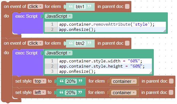

2022-09-10 at 7:26 pm #55738kdv
ParticipantWorks as expected
2022-09-11 at 12:51 pm #55747michael64
ParticipantI’m using only Javascript to build the app. No puzzle.
Could now solve my issue by calling app.onResize() after 200ms using timeout.setTimeout(function(){ app.onResize(); }, 200);For some reasons the app wasn’t able to get the correct width without using the timeout.
The solution is a little bit ugly but ok for now.
But thanks for the hint.
2022-09-11 at 12:57 pm #55748kdv
In fact, it doesn’t matter. Show your code that reacts on the container resizing.
