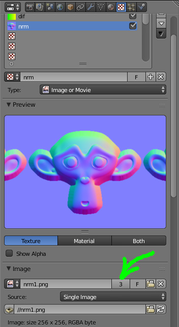

CustomerI’ve run into a problem, in that this changes the texture for every object in the scene that uses that texture, even if it has a different material. I plan to have at least 5 objects that would be swappable, do I need five different versions of each texture? I thought the objName parameter would mean that it only gets swapped for that object, as opposed to across the scene.
In the example, even the leftmost icons get the texture swapped out for the monkey head or gradient, though the other icons don’t.
2018-04-05 at 2:21 pm #3397
Yuri KovelenovStaffHi,
You can avoid this behavior by unsharing an image in Blender: just click the numbered button to make a copy.
