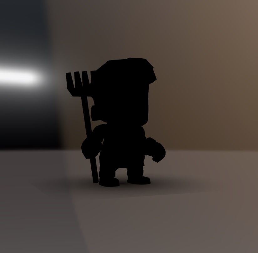

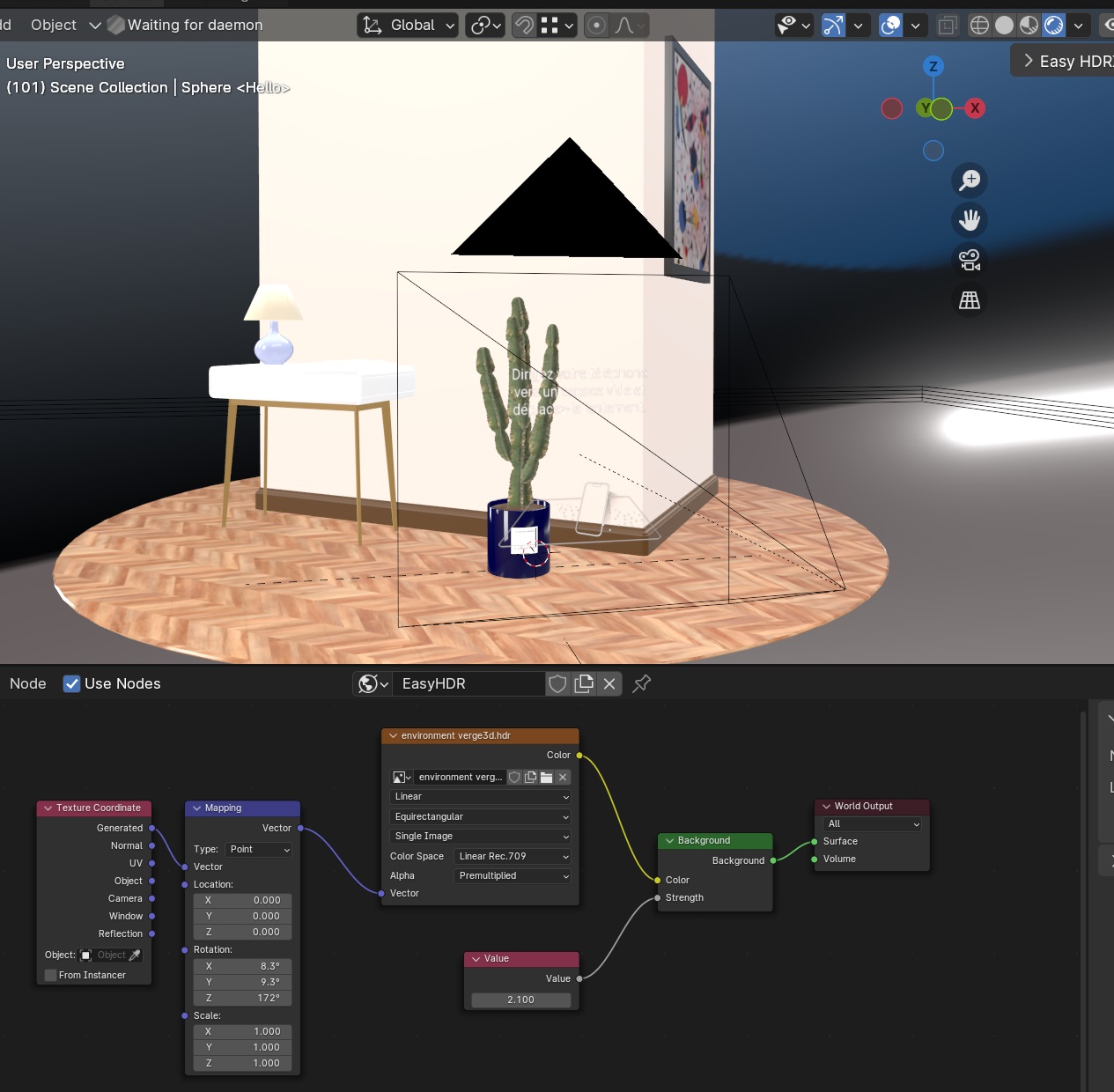

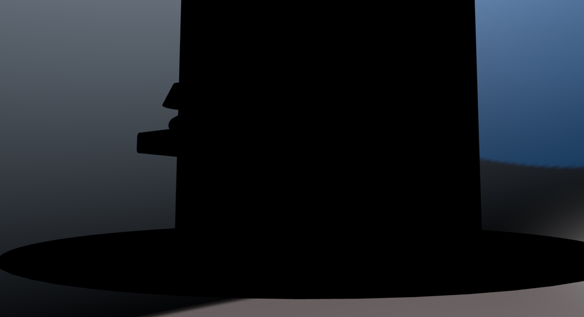

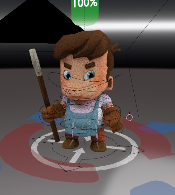

I have duplicated the new version of DEMO AR but I can’t figure out how to light my scene (The AR demo uses Emission to light the Farmer mesh but I would hope their is an other way).
I want to use the light of my HDRI and it seems to be no problem on my viewport. But when I click on sneak peak it becomes pitch black.If I had a light source it works fine though but it would require too many of them =.
It might be very obvious but I can’t find where

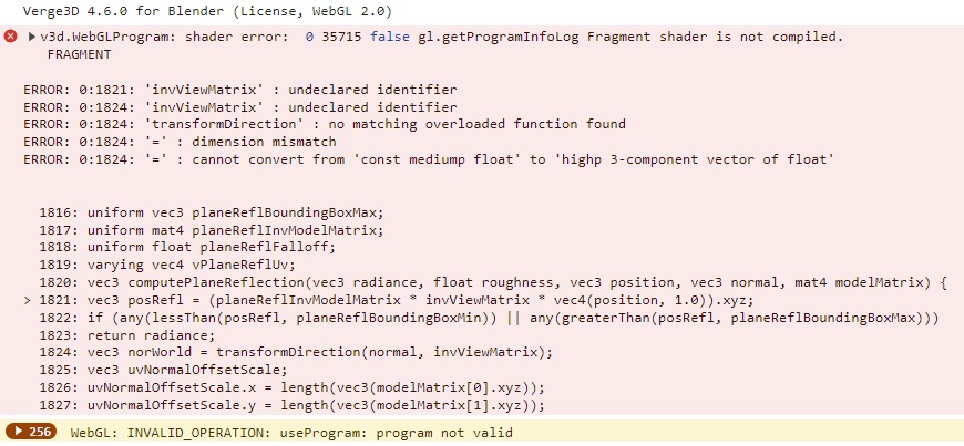

ParticipantIn your browser press F12 and see the log.
2024-04-04 at 8:55 am #72092jojopellerin
CustomerHi kdv,
It seems to be an issue with the “Fragment shader” that doesn’t compile.
I haven’t noticed any other issue besides this one.Don’t know if it worth mentioning but the HDRI I am using is the “environment verge3d.hdr”.

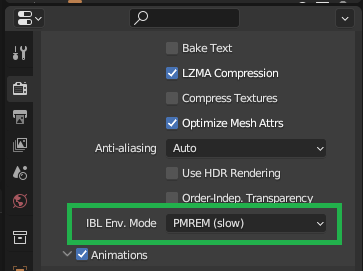

Did you download the latest AR Demo from the Asset store and just open .blend file with no changes? I did the same and see no problems with the HDRi lighting at all
Blender 3.6.9Check this option in Blender. It shouldn’t be
None (fastest).
2024-04-04 at 1:57 pm #72099
Alexander KovelenovStaff2024-04-04 at 2:18 pm #72100jojopellerin
CustomerYou are right !!
It was on None (fastest) by default. It works now :)
Thank you for your help again
