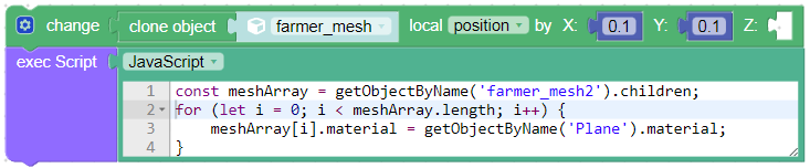

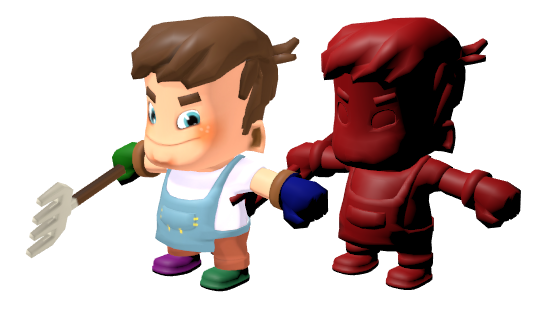

    Hello i am in a situation where i clone an object that has multiple materials assigned to it. however i want to make the cloned object completely red. To do this i have to first remove all other materials assigned to it. How do i do this without removing the materials from the scene and only on the clone?
    #54278
    create an additonal material in your 3D editor and apply it to some invisible primitive object. You can’t use assign material puzzle to replace all material, it replaces only the first material. Use this script instead
    'farmer_mesh2' is the name of the first clone (the second clone will be named 'farmer_mesh3' and so on), 'Plane' is the name of the invisible primitive.
    The previous materials will stay in Scene on the original object.
