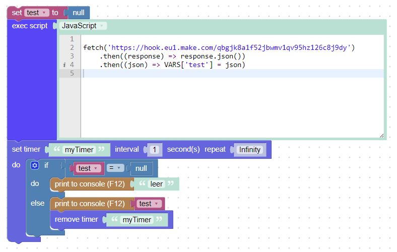

    just remove these stupid if else from the code and read JSON as you did it before 4.1+. These three lines of code made a lot of problems )))
    indexOf('application/json' > -1) ONLY if the file extension is .json. but it can be .gltf or any other extension or no extension at all))) In fact, it was a bad idea to add this feature. There is a good puzzle read JSON from and it works good with all files…

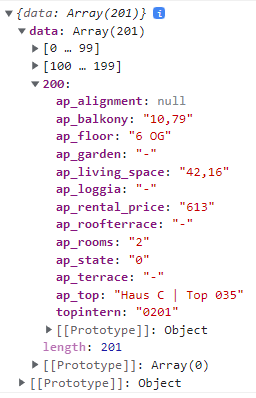

    thanks for the help! I tried it and the error message disappeared, but somehow the json file could not be read – the variable remained empty.
    I have now thought of my own solution which I would like to share here in case someone encounters the same problem.
    #58862
    read JSON as you did it before 4.1+ means this set of puzzles: load data from a file -> read JSON from loaded data
    see no problems with your json file…
