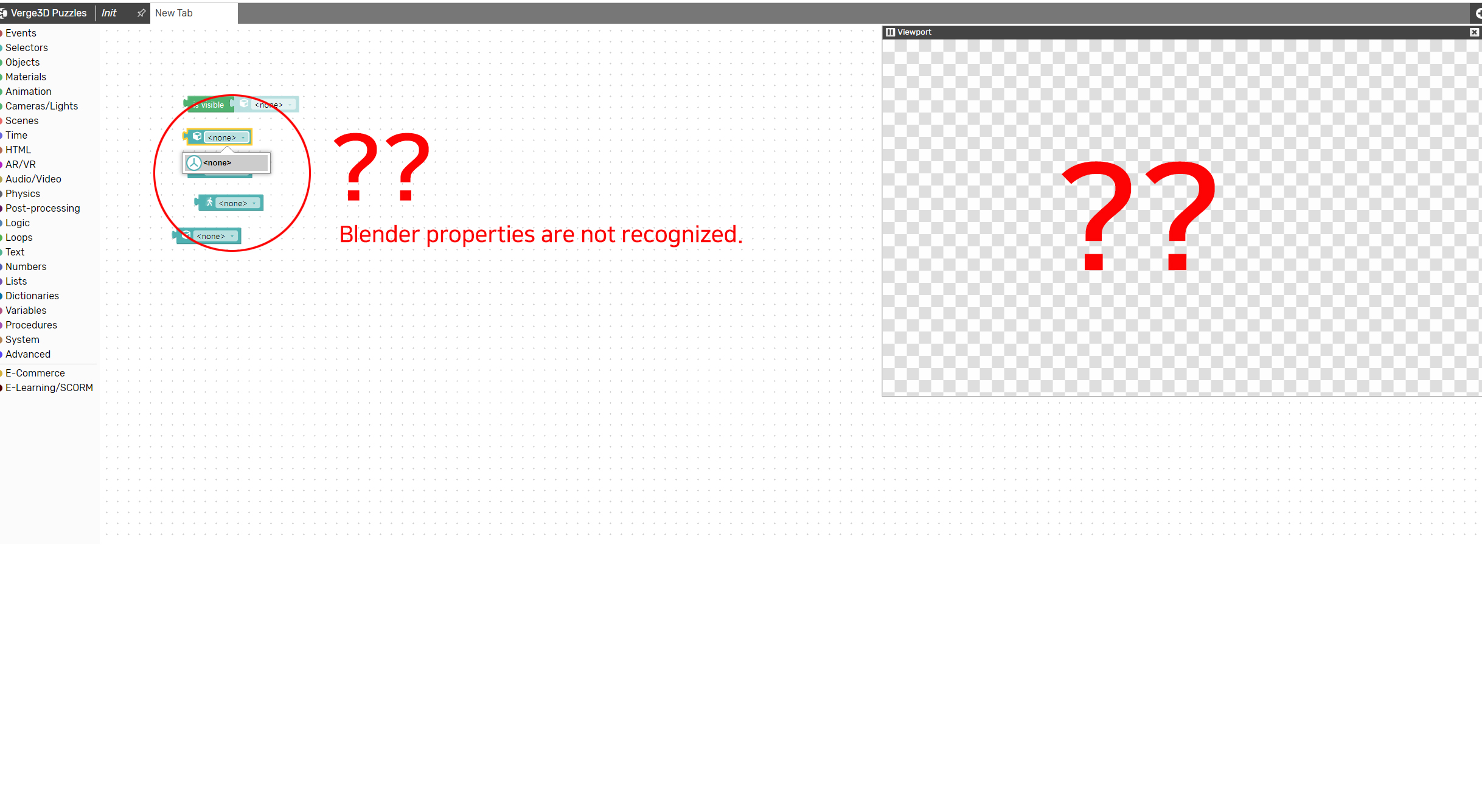

dusik geum
CustomerPuzzle selector does not recognize properties of blender
It’s not my first time using verge3d.

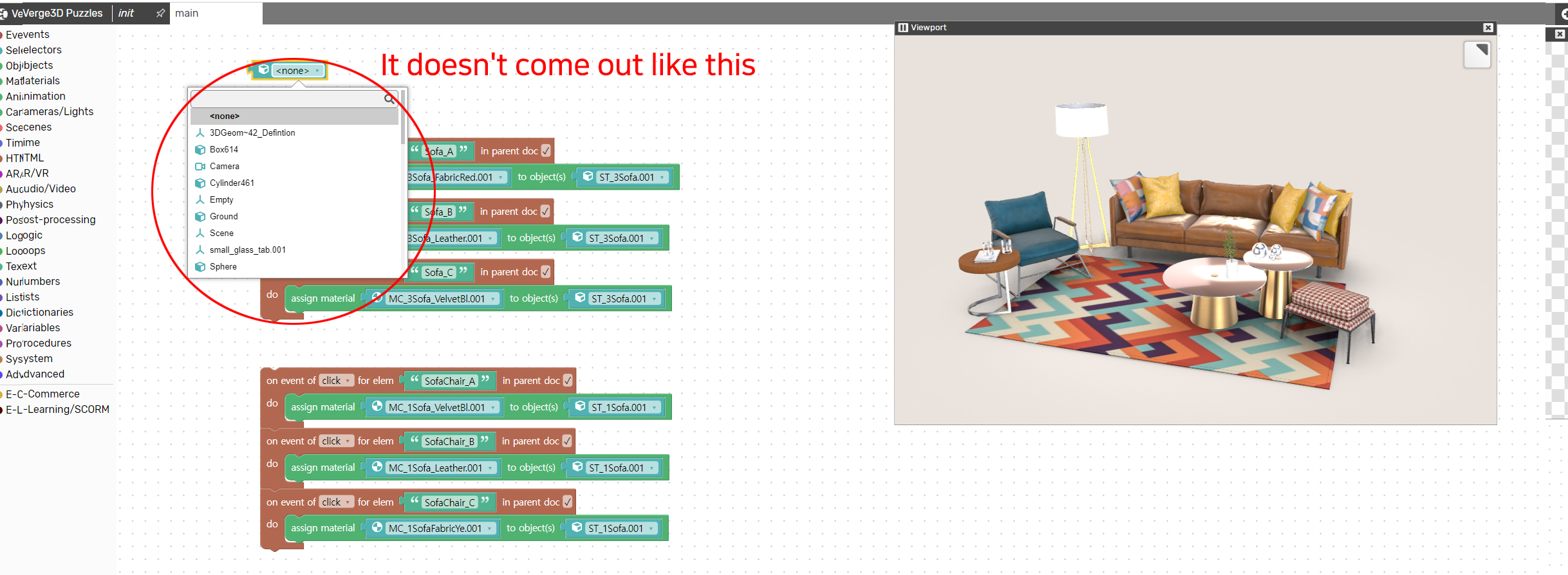

The attributes of the blender are not recognized by the selector in the puzzle It all comes out as none.Am I mistaken for something???
It’s been a while since I’ve used it, but why can’t I read the properties of the mesh or the material. And even in the right viewport, the blender mesh cannot be loaded. I’m curious.2023-11-18 at 5:29 am #68633kdv

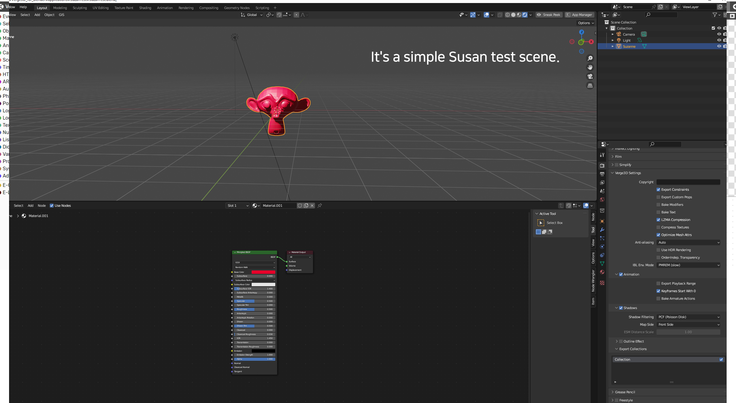

It’s a very simple blender file. I don’t know why the puzzle doesn’t recognize the mesh.
Blander is 4.0 and verge3d is upgraded to 4.5. I would like to express my gratitude to everyone who is interested.2023-11-18 at 11:56 am #68644kdv
