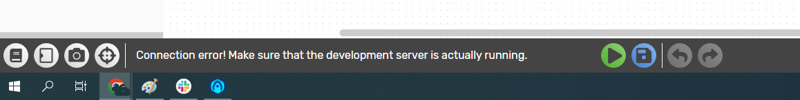

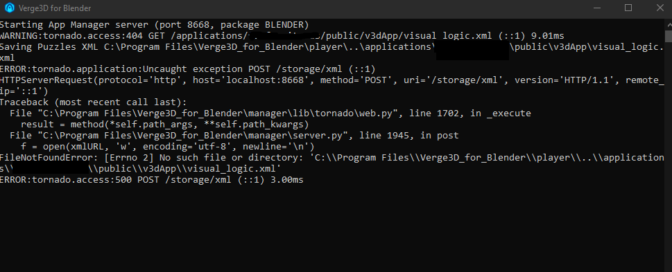

    Hello,
    I’m having an issue with saving my puzzle on my project,
    the local server crashed and I cannot save the puzzle file
    PS: I have followed the instructions on the doc for using the puzzle on React/Vue app, the same method works fine on elder versions, but on the 4.0.1 version it doesn’t work anymore.
    THANKS

    Hi aminemod,
    Currently the docs for using React/Vue with the puzzles editor don’t reflect changes made in verge3d 4.0 regarding how the editor works with its applications. We’ll fix the instruction in the docs in the next verge3d update. But for now, if you need React/Vue it’s better to stay on Verge3D 3.9.1. Sorry for the inconvenience.

    UPDATE: Verge3D 4.1 pre1 is out and the new info about using Puzzles with a React/Vue app can be found here: https://www.soft8soft.com/docs/manual/en/programmers_guide/Integration-with-Reactjs-Vuejs.html#using_the_puzzles_editor – it requires a new app template added in 4.1, so you need to update to the new version if you want to check it out
