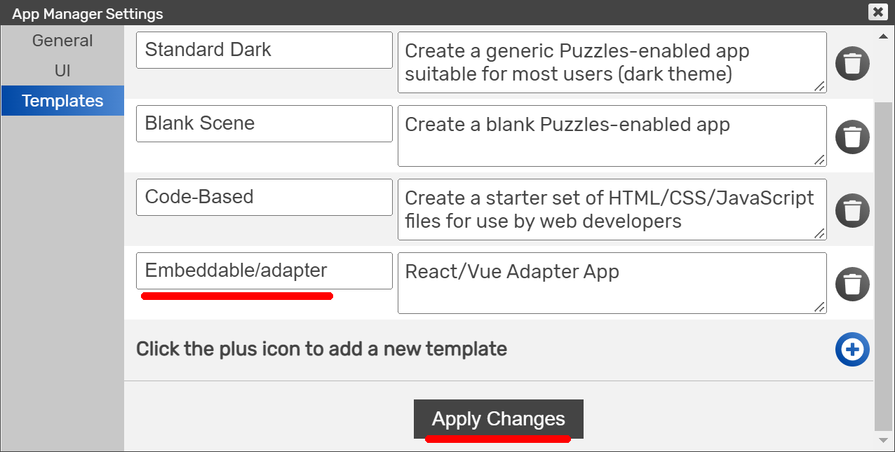

App Manager Setup

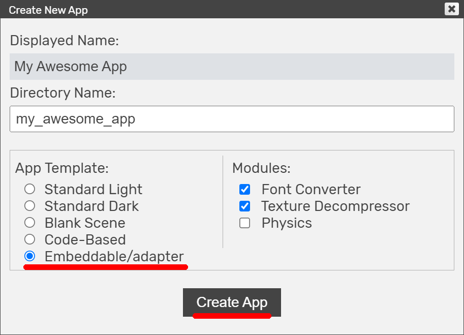

Suppose we have a React or a Vue application created according to the guide described in this manual. In order to "connect" the App Manager and the React/Vue project we need to create a dedicated "adapter" application. That's a custom app template, which is not present by default in the App Manager but can be added in the App Manager Settings. Let's do that by following the Creating Templates tutorial but when it comes to naming the new template let's put Embeddable/adapter into the name field. Next, let's hit the Apply Changes button and the template will be successfully added to the App Manager:

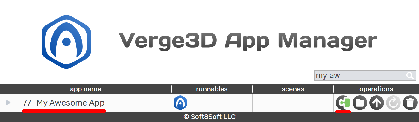

Then, we need to create a new application using the newly added template. Let's call it my_awesome_app:
Finally, we need to create symbolic links pointing to resources in the React/Vue project that the App Manager needs to be able to launch the Puzzles Editor. Suppose that the React/Vue project is located at the path MY_PATH and your Verge3D applications folder is located at the path V3D_APPS_PATH.
You can check where Verge3D stores your applications in App Manager Settings -> General -> Applications Folder.
We'll create a symbolic link pointing from V3D_APPS_PATH/my_awesome_app/v3dApp to MY_PATH/public/v3dApp - the latter is the place inside the React/Vue project where verge3d-related scene resources are stored. Also, we need to create a couple more symbolic links for Puzzles' logic JS and XML files. Here's how this can be done:

Now you can see your project in the Application Manager and you can use the Puzzles Editor.

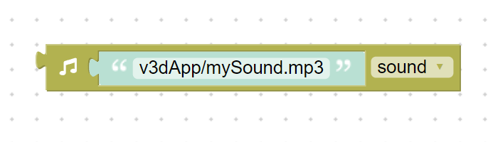

So, if, for example, we want to load a sound file via puzzles, then that
file, let's name it sound.mp3, should be placed inside the public/v3dApp
directory (or its subdirectories). After that the file can be loaded by
using v3dApp/mySound.mp3 inside the URL field in the
load sound puzzle:
