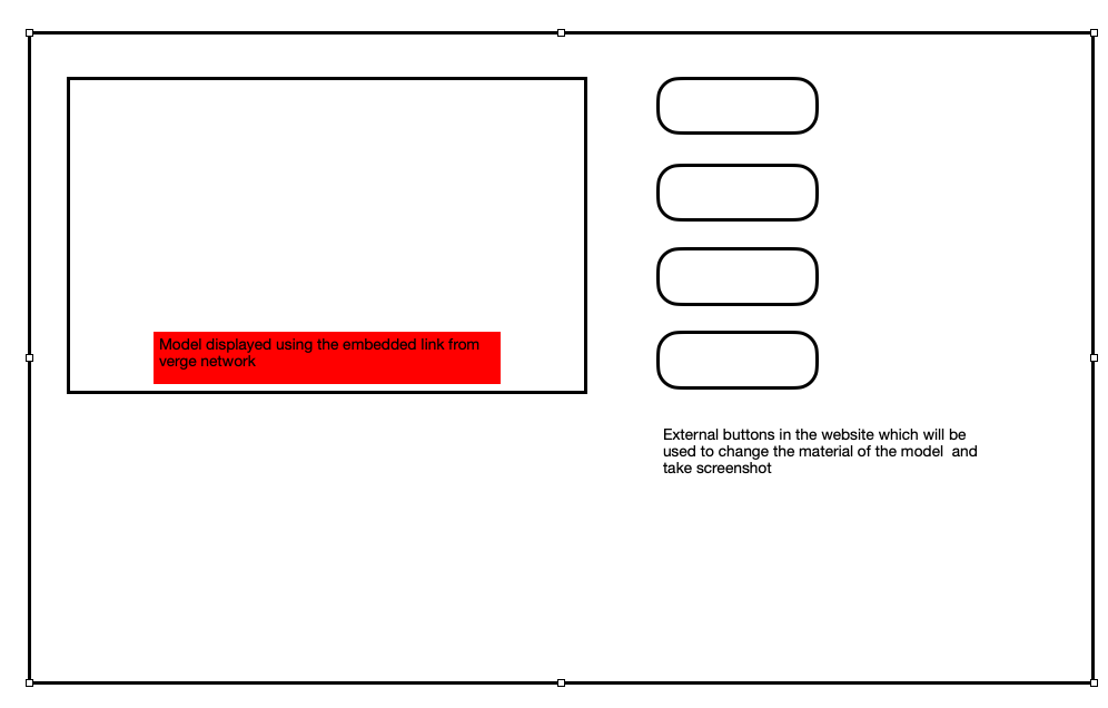

    I want to create a prototype for my client as a proof of concept. Is it possible to change model materials and taking screenshot of the model(puzzle actions) from an external interface like buttons in a website by just using the embedded link from verge3d network. how can I make it possible?
    I have attached a screenshot below as a reference.

    Do you want to show some random app from the v3d network in an iframe and have an opportunity to change smth in it?

    More likely the answer is no than yes. You know nothing about objects and materials in these random apps and have no access to them. For example, what material are you going to change? Do you know its name?
    Theoretically, it’s possible to read app_name.js, append it in your HTML and load the app in an iframe as your own app. To make changes and screenshots you’ll need to change the path to your visual_logic.js before the script is loaded…

    It’s possible but you need to use messaging and JavaScript to overcome security restrictions imposed on cross-domain requests.
    Anyway, this use case does not look so rare, perhaps we need to implement something in Puzzles for that.

    I believe no, this won’t be possible. You can put Puzzles to the Verge3D app itself, not to the third-party page. However, JavaScript logic with messaging approach would be quite simple.
