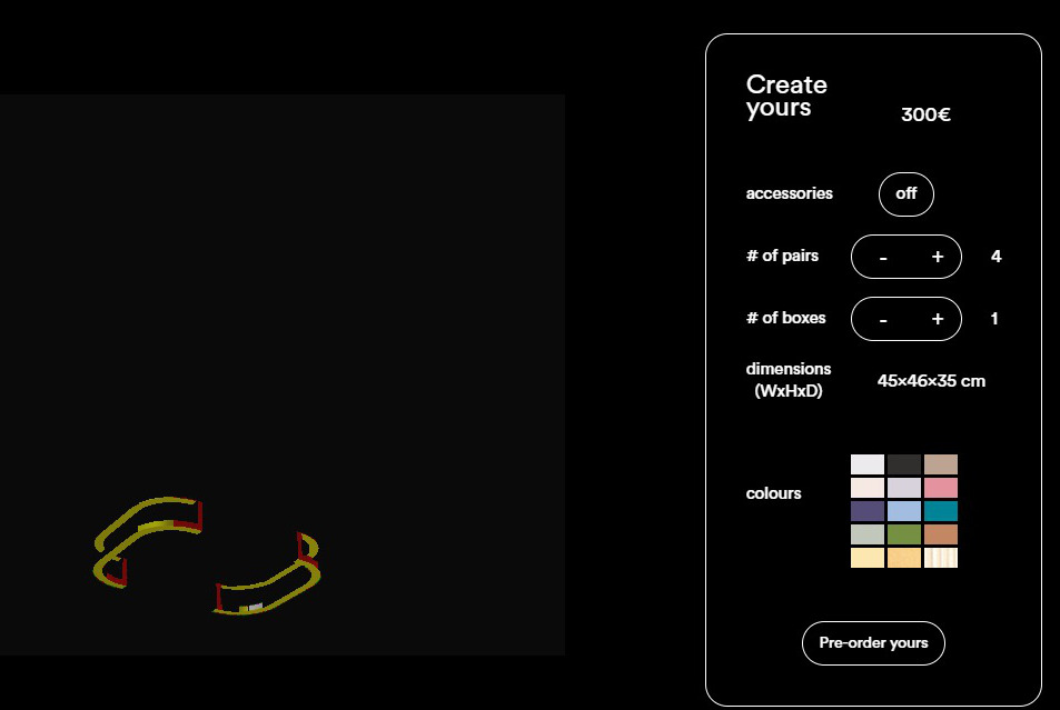

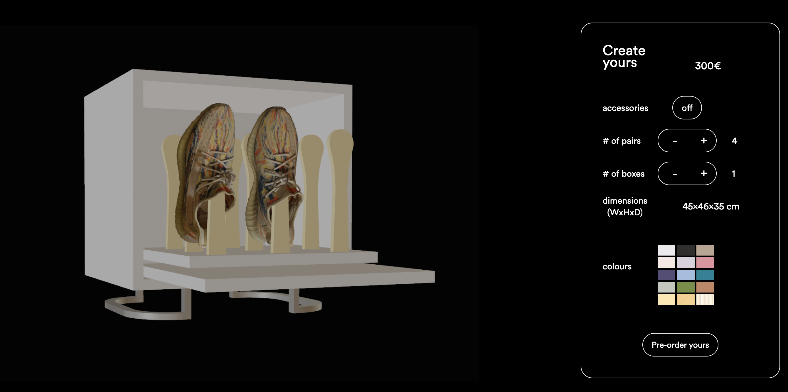

    The problem arises when I use a real Windows machine. Although it is a laptop with dedicated 3D graphics card and with “good performance” as stated by WebGL System Report page, the model doesn’t show (only metallic parts appear although not correctly textured). Curiously, when I test the configurator under a real Windows 10 installation through BootCamp on my MacBook everything works well. Attached you can find the correct expected result and the problematic one under real Windows. Could you please help me with this issue?

    From the second picture it looks like it may be a shader crash. Can you check the browser console to see if it shows any errors?

    Hi Ivan. Here is the output at Chrome’s console:

    Hi!
    It will be better to use Verge3D 4.0 pre4 or you can also wait for the official release of Verge3d 4.0.

    The display issue under Windows was solved using 4.0-pre version.
    Thanks for the tip!
