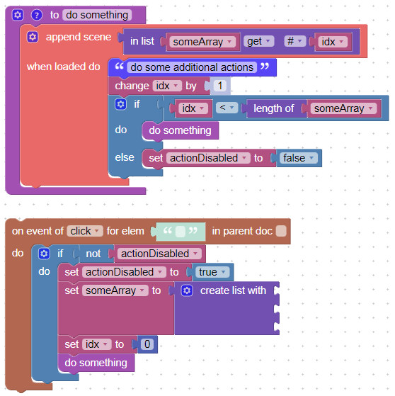

    Here is the piece of puzzle:
    I would like to make sure that the “addGenericObject” or “addCustomObject” procedures have completed before to move on to the next object in the for loop… Everything looks like the for loop goes “quicker” than the import process, and that cause my procedures to fail (the import seems to import correctly – no “on error” action triggered) but all the stuff that I need to do inside these procedure do not complete.
    #66905
    Much-much quicker, ~0-1 ms for all iterations.
    You may want to use a looped procedure for async functions to start the next iteration right after the previous one has been finished. Something like this
