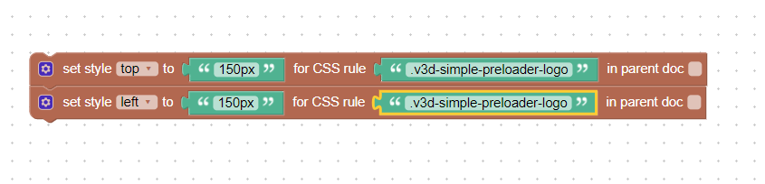

    #27457
    position can be changed with the very same set style puzzle, using top and left attributes

    Hello Yuri,
    please be so freindly and send me example screenshot if possible ?
    Best regards
    Marcus
    #27474
    Here you go.
    #27479

    #27483
    doehlma
    I solved it by myself .. I added the height and width setup and now it is running
