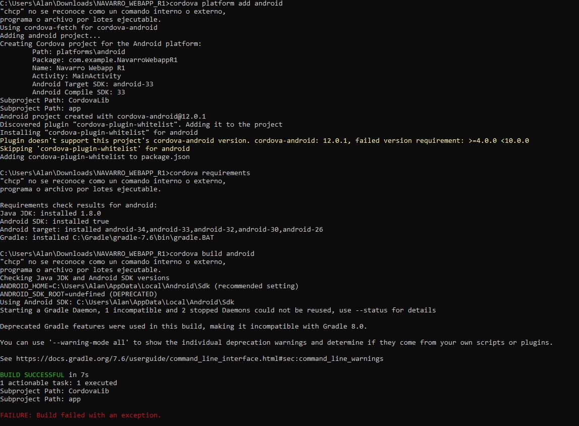

CustomerHi, still having trouble building for android. Here’s the cmd lines:
C:\Users\Alan\Downloads\NAVARRO_WEBAPP_R1>cordova platform add android
“chcp” no se reconoce como un comando interno o externo,
programa o archivo por lotes ejecutable.
Using cordova-fetch for cordova-android
Adding android project…
Creating Cordova project for the Android platform:
Path: platforms\android
Package: com.example.NavarroWebappR1
Name: Navarro Webapp R1
Activity: MainActivity
Android Target SDK: android-33
Android Compile SDK: 33
Subproject Path: CordovaLib
Subproject Path: app
Android project created with cordova-android@12.0.1
Discovered plugin “cordova-plugin-whitelist”. Adding it to the project
Installing “cordova-plugin-whitelist” for android
Plugin doesn’t support this project’s cordova-android version. cordova-android: 12.0.1, failed version requirement: >=4.0.0 <10.0.0
Skipping ‘cordova-plugin-whitelist’ for android
Adding cordova-plugin-whitelist to package.jsonC:\Users\Alan\Downloads\NAVARRO_WEBAPP_R1>cordova requirements
programa o archivo por lotes ejecutable.Requirements check results for android:
Java JDK: installed 1.8.0
Android SDK: installed true
Android target: installed android-34,android-33,android-32,android-30,android-26
Gradle: installed C:\Gradle\gradle-7.6\bin\gradle.BATC:\Users\Alan\Downloads\NAVARRO_WEBAPP_R1>cordova build android
Checking Java JDK and Android SDK versions
ANDROID_HOME=C:\Users\Alan\AppData\Local\Android\Sdk (recommended setting)
ANDROID_SDK_ROOT=undefined (DEPRECATED)
Using Android SDK: C:\Users\Alan\AppData\Local\Android\Sdk
Starting a Gradle Daemon, 1 incompatible and 2 stopped Daemons could not be reused, use –status for detailsDeprecated Gradle features were used in this build, making it incompatible with Gradle 8.0.
You can use ‘–warning-mode all’ to show the individual deprecation warnings and determine if they come from your own scripts or plugins.
See https://docs.gradle.org/7.6/userguide/command_line_interface.html#sec:command_line_warnings
BUILD SUCCESSFUL in 7s
1 actionable task: 1 executed
Subproject Path: appFAILURE: Build failed with an exception.

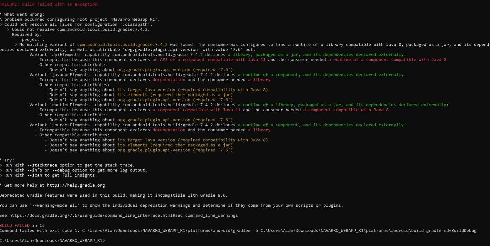

* What went wrong:
A problem occurred configuring root project ‘Navarro Webapp R1’.
> Could not resolve all files for configuration ‘:classpath’.
> Could not resolve com.android.tools.build:gradle:7.4.2.
Required by:
project :
> No matching variant of com.android.tools.build:gradle:7.4.2 was found. The consumer was configured to find a runtime of a library compatible with Java 8, packaged as a jar, and its dependencies declared externally, as well as attribute ‘org.gradle.plugin.api-version’ with value ‘7.6’ but:
– Variant ‘apiElements’ capability com.android.tools.build:gradle:7.4.2 declares a library, packaged as a jar, and its dependencies declared externally:
– Incompatible because this component declares an API of a component compatible with Java 11 and the consumer needed a runtime of a component compatible with Java 8
– Other compatible attribute:
– Doesn’t say anything about org.gradle.plugin.api-version (required ‘7.6’)
– Variant ‘javadocElements’ capability com.android.tools.build:gradle:7.4.2 declares a runtime of a component, and its dependencies declared externally:
– Incompatible because this component declares documentation and the consumer needed a library
– Other compatible attributes:
– Doesn’t say anything about its target Java version (required compatibility with Java 8)
– Doesn’t say anything about its elements (required them packaged as a jar)
– Variant ‘runtimeElements’ capability com.android.tools.build:gradle:7.4.2 declares a runtime of a library, packaged as a jar, and its dependencies declared externally:
– Incompatible because this component declares a component compatible with Java 11 and the consumer needed a component compatible with Java 8
– Variant ‘sourcesElements’ capability com.android.tools.build:gradle:7.4.2 declares a runtime of a component, and its dependencies declared externally:
– Doesn’t say anything about org.gradle.plugin.api-version (required ‘7.6’)* Try:
> Run with –stacktrace option to get the stack trace.
> Run with –info or –debug option to get more log output.
> Run with –scan to get full insights.* Get more help at https://help.gradle.org
BUILD FAILED in 1s
Command failed with exit code 1: C:\Users\Alan\Downloads\NAVARRO_WEBAPP_R1\platforms\android\gradlew -b C:\Users\Alan\Downloads\NAVARRO_WEBAPP_R1\platforms\android\build.gradle cdvBuildDebug2024-02-26 at 6:30 am #71139
Alexander KovelenovStaffHi,
It appears you running an older version of Java. The string:Java JDK: installed 1.8.0says that you have Java/JDK 8, but it’s required to have Java/JDK 11 for the latest versions of Cordova. Please upgrade Java and try again.

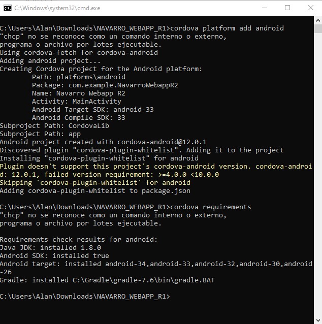

2024-02-26 at 3:14 pm #71153alanzb
CustomerHi! Many thanks for your answer.
I’ve installed JDK11, however, it keeps saying the same:
Package: com.example.NavarroWebappR2
Name: Navarro Webapp R2
Gradle: installed C:\Gradle\gradle-7.6\bin\gradle.BATI have no experience in development, so i will aprecciate your help. This is a project for an important costumer and i love Verge 3d
