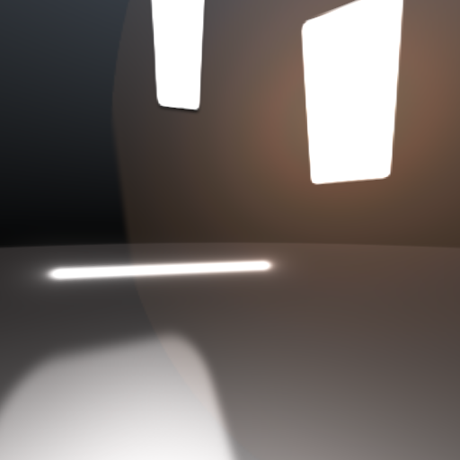

Mikhail LuzyaninStaffSorry, but I’ve deleted it and it’s simple I’ve just put a simple sphere instead of teapots, just to get better view of reflections.

First off, those lights were *really* playing up, so I deleted them and started again. I also moved them *really* close to the object, and (with a VERY high intensity value) AND basing my materials on the one you provided, YES, I DO now see photometric lights :)
Yay !!!!
However……
Again…. only in Sneak Peek. NOT when I run the app….
So….. could this be a Puzzle issue maybe?
Once again, many many thanks for your help.
We’re getting there :)

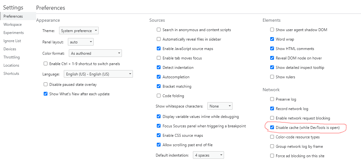

Mikhail LuzyaninStaffMay be there’s a cash. Try to go to browser console > settings > then Disable cash while DevTools is open.
2021-09-29 at 12:13 pm #45454jezuk
CustomerNo, i don’t even have the console open, (but I checked its value anyway).
Also, I try in different browsers, different machines, including iPad, surface pro and smartphone.
All show result without photometric lights in App manager, sneak peek shows photometric light reflections and illumination contribution from photometric lights.
