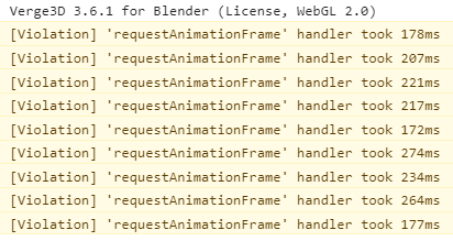

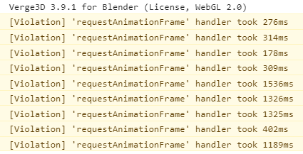

2022-05-20 at 7:14 am #52217kdv
Participant3.6.1 vs 3.9.1 in the same conditions.
3.8.1-3.9.1+ are really much slower in “hide-show”…
