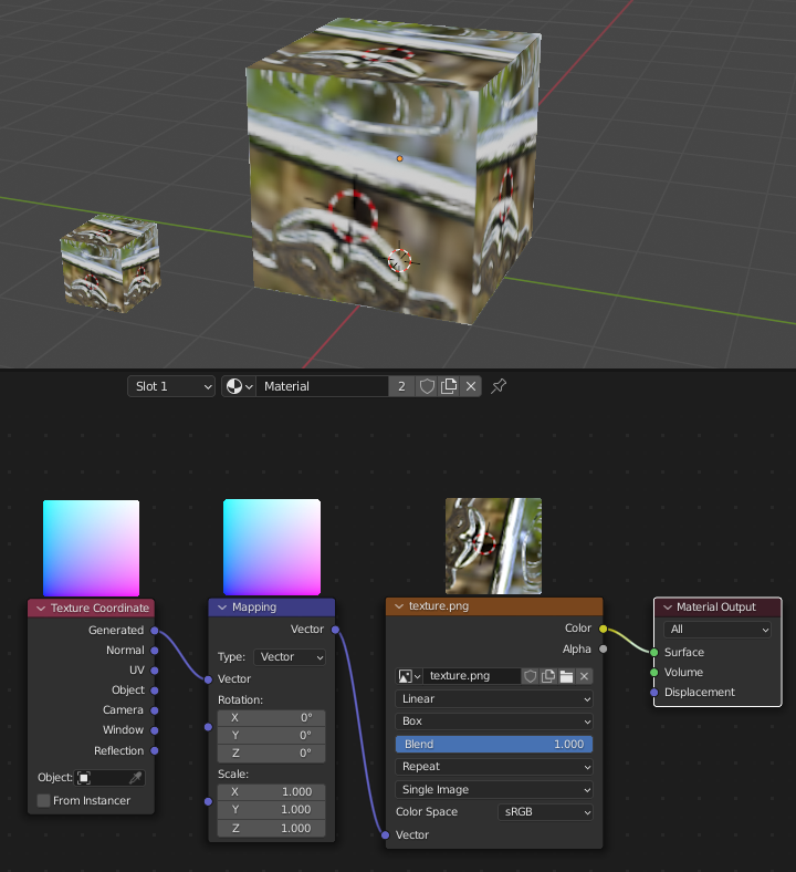

    As object texture coordinates have some weird problems regarding object rotations. I am trying to use generated texture coordinates to procedurally map multiple objects at the same time.
    By doing so I noticed that verge3d doesn’t take into account adjustments to the mesh texture space.
    Are there any plans in supporting that?

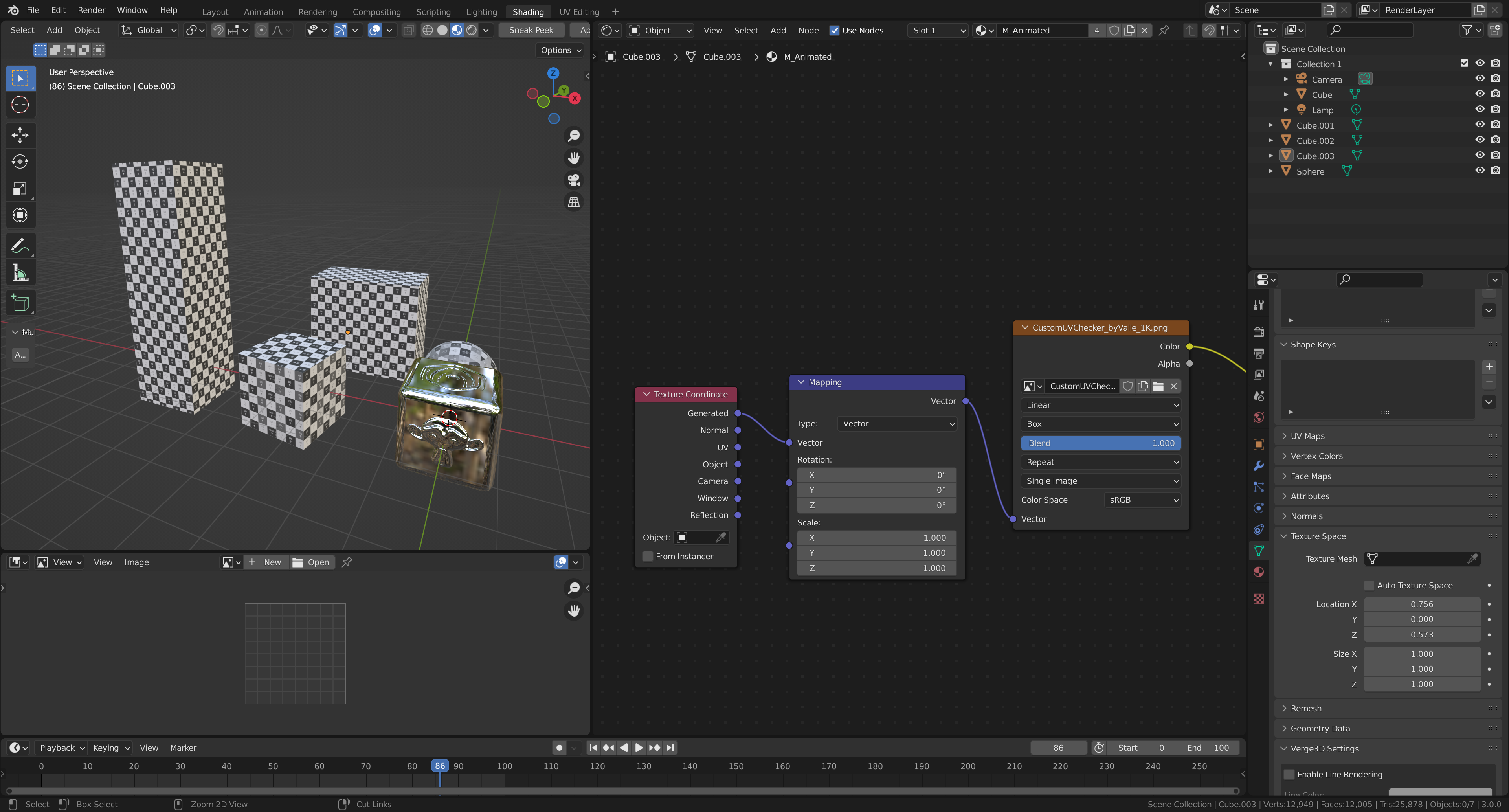

    #48787
    Works for me fine.
    Can you share your example?

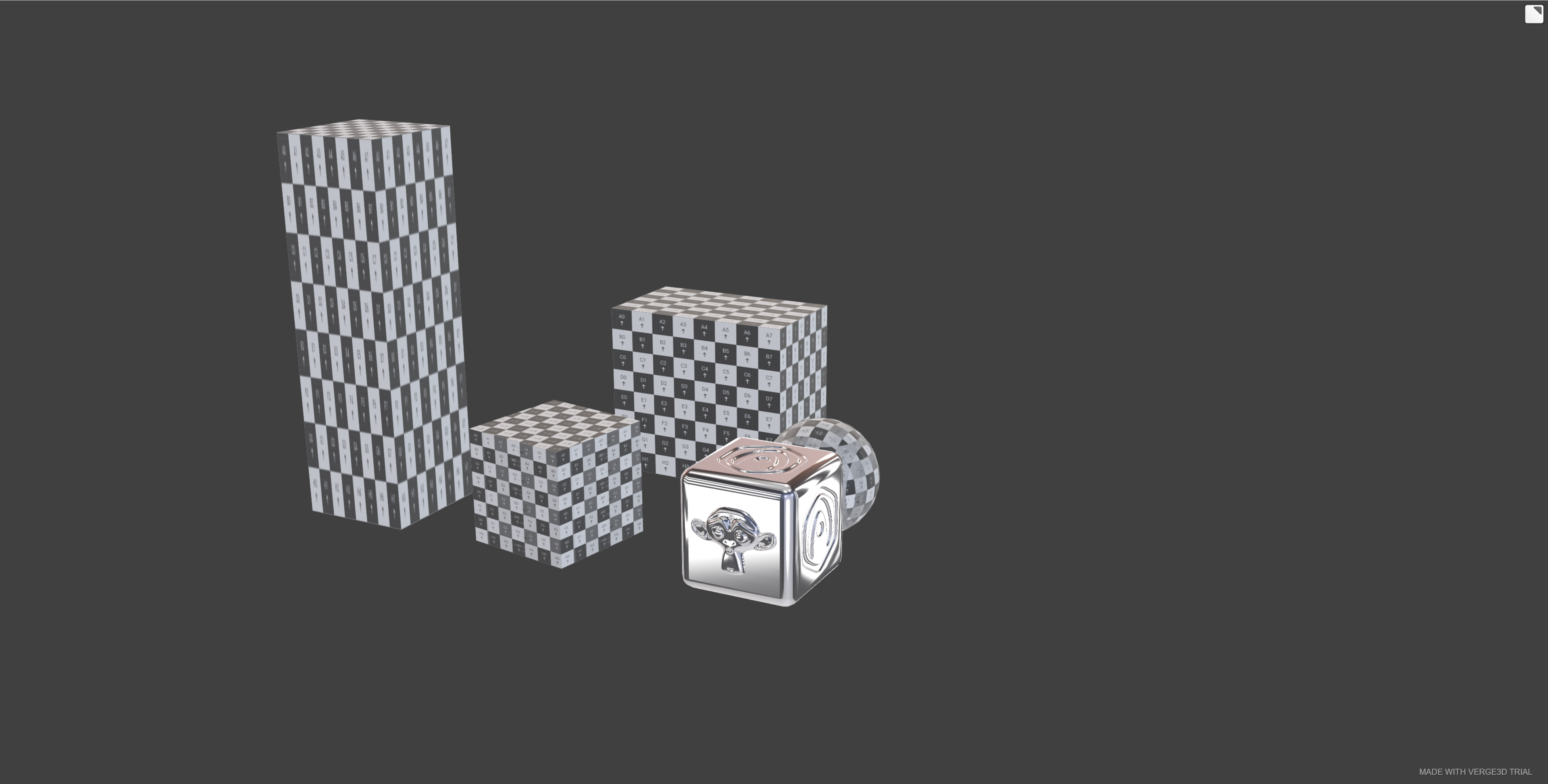

    AVerge3Der
    My results.

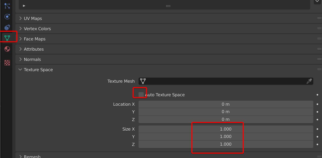

    hulpesergiu
    In both your examples the textures space has not been edited. After editing the texture space, the texel density should be the same between the 2 objects.
    I will also post an example later, but here is a screenshot of how to adjust an object’s texture space. After doing this, the mesh can be non-uniformly scaled, but the texture tiling size will remain constant.
