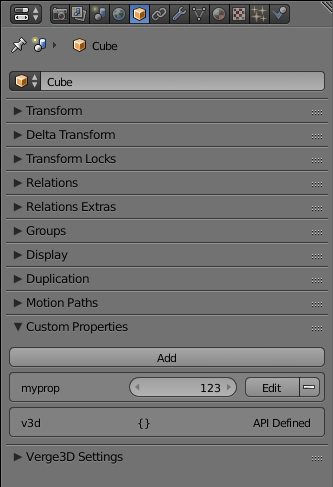

    User-defined data can be exported and accessed as follows:
    1. Create and set a property in Blender

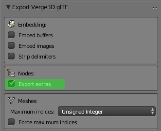

    2. Select Export Extras in the export options (on the left toolbox) upon exporting to glTF
    3. Then your property should appear in .userData
    var obj = v3dApp.scene.getObjectByName(“Cube”);
    obj.userData.myprop // e.g. 123

    I just tested the technique that you described. It works perfectly! This feature is excellent and useful. :good:
